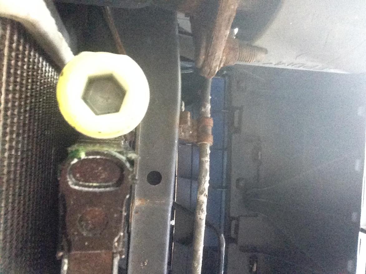

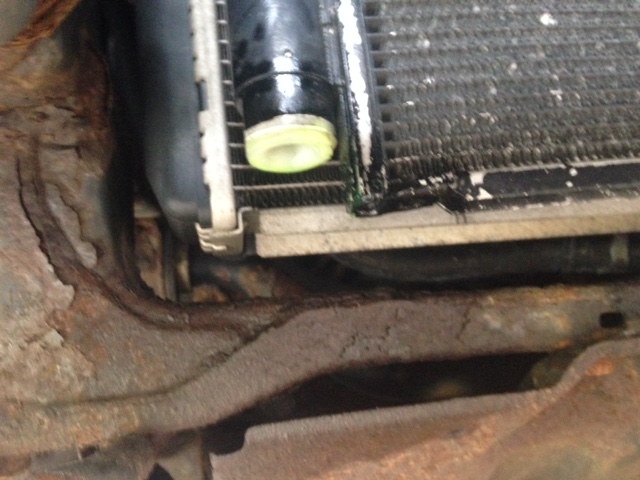

I noticed some coolant on my driveway and it appears it's leaking very slowly from this white tube. Has anyone experienced this issue?

Radiator leaks are fairly common but you should definitely address it.
I'm more concerned about the coolant being green. Toyota coolant (or coolant approved for use in our engines) is pink or red in most cases.
I'm sure the more experienced people will chime in and can verify. I could be wrong.
first thing we need to know, what color is your coolant? if you think the leak is coming from the radiator, then, replacing the radiator will fix it.
That appears to be the AC Condenser assembly, typically AC refrigerant and oil is dyed these days with a greenish looking dye that is florescent under UV light.
