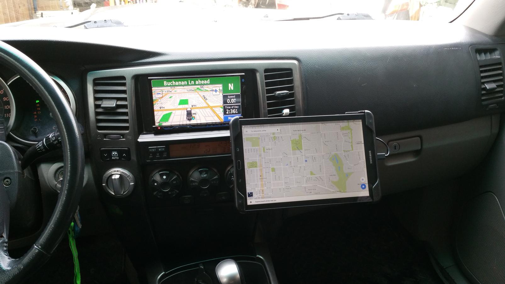

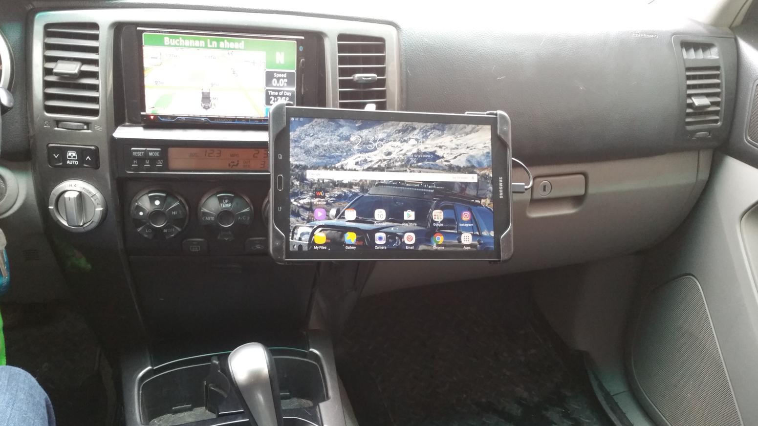

In preparation for next springs big overland trip, a purchased a tablet with offline GPS navigation with topo maps. Utilized a RAM mount fixed to the dash.
