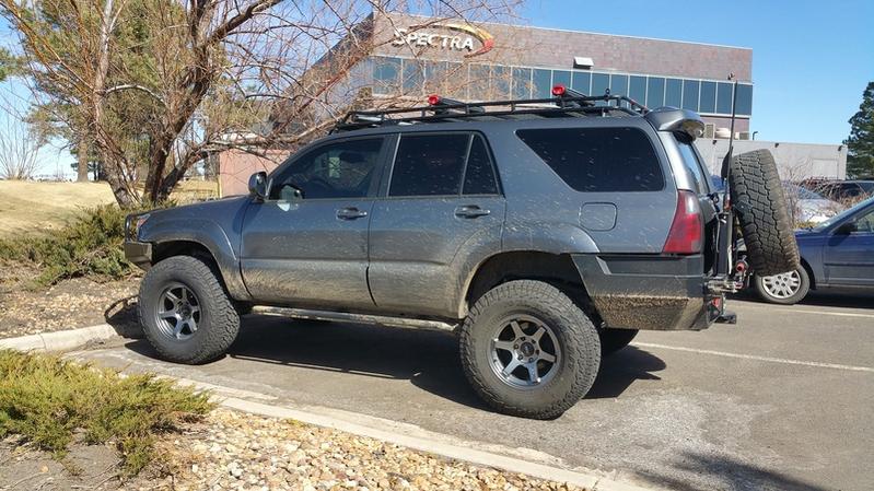

Opted to go back to an All Terrain tire in order to run year round. The KM2's sure where good looking, but I didn't want to run in the snow here in Colorado.
Opted for the Falken AT3W 285/75/17 mounted to the new Relations Race Wheels R2 17x8.5. *Note, these wheels do not fit 4th Gen 4runner hub dust shields. They only worked since we ran spidertrax with them. Not happy with the RRW sales guy about this oversight*
Tires are nice and big, quiet on the roads. The sidewalls aren't as burly looking as the KM2s or Duratracs, but overall they are nice looking tires for a great price.

Great choice on the new tires! I still love mine. Think they look great in that size on your rig too. I found them to be slightly larger than similarly sized AT so betting those look huge in person.

Yes, the 285/75/17 Falkens look pretty big. I've had 2 people in the paste 24 hours come up and ask if they were 35's. Driving today - man, they sure are smooth and quiet. Such a nice bonus.
Haha, sounds about right. Assuming I don't necessarily need the MT, I always prefer an AT, even in the all-important appearance category (look fatter IMO). These have been the best ATs I've ran to date. Just rotated them with a little over 5k miles and they're still as quite and smooth. They may still wear fast but a lot of the initial wear shock was due to people starting out with 13/32 instead of 14/32 as advertised by Falcon. Time will tell...

Looks perfect! Planning to switch from my 285/70s Wildpeaks to them in 285/75 when next due. Hope you love your Wildpeaks as much as I love mine, great performer at the price point, especially if they hold up long term. Paid under $600 mounted for mine
The new shoes look great! Those are on my short list of tires when it is time for me to replace mine.

Interested in these tires for the longer run. My last experience with Falken wasn't the greatest. Had the Rocky Mountain/Wildpeaks, they were lacking in everything. I am interested in going back to the smoother/quieter true A/T world as well.

Glad to hear you're still liking them. I'm about to roll over 10k on them. Just had them rotated and still super quite. Got around 10-11/32" showing. Not bad as they came with 13/32nds.
