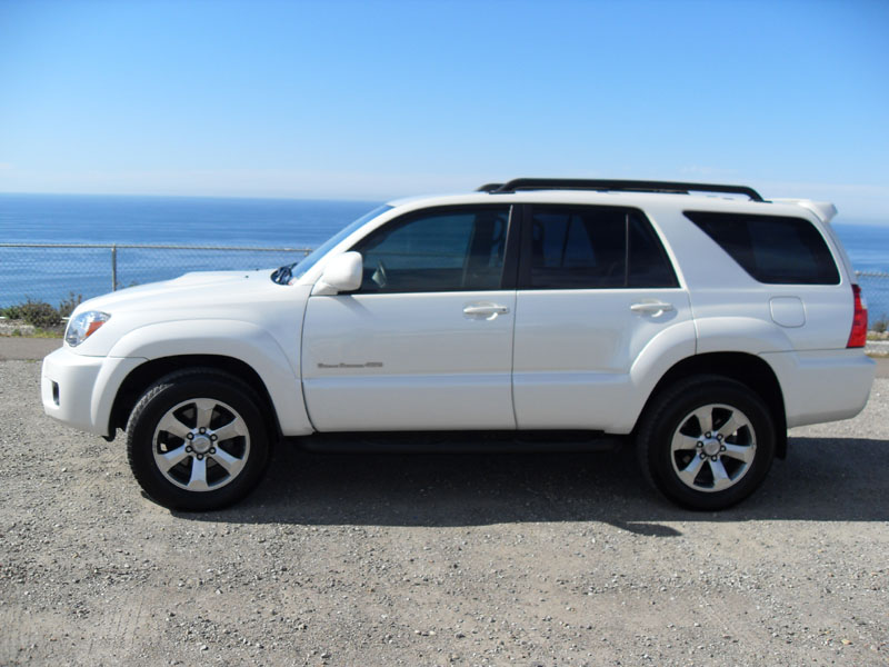

Also just noticed where the front door meets the fender. Is there a body line there that doesn't match up? The 06+ front flares meet up with the flares on the door so it appears as one streamline piece, like where the rear door meets the rear flare..see below.
39309d1297650280-2008-urban-runner-immaculate-condition-san-diego-03_driver_side_sm.jpg
Yeah it doesn't match the lines from the doors to front fender. It was probably cheaper to fix with 03-05 parts and was do e at a less than reputable shop. I would go back to the dealer and plead your case. That's not a true 06.
