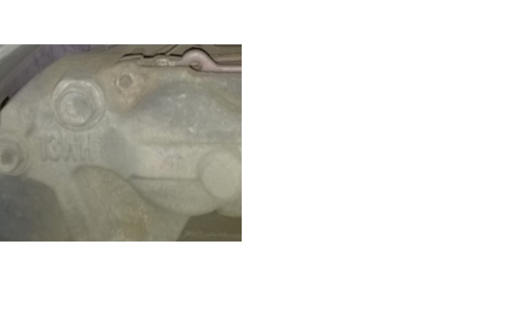

I just got home from work and I am working on my truck right now. I took a quick picture for reference; you can easily see the marking without removing the wheel. Just pop your head around the back side of the tire and look at the back of the caliper.
Here's the driver's side on mine:

Thanks. I just put my phone behind the wheel to take a picture and confirmed that it came with a bigger one. "13WH".
