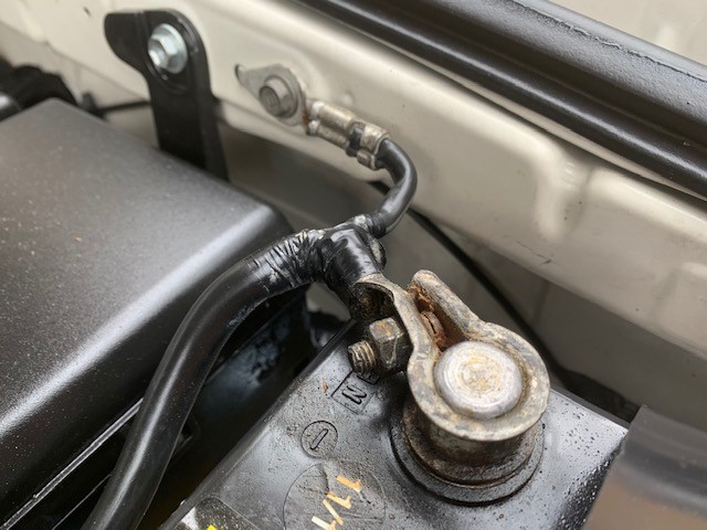

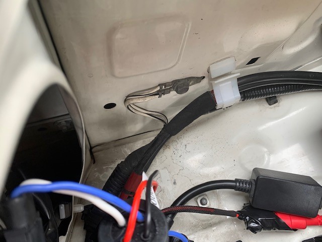

Hi Everyone,
I installed some HID bulbs in my 08 to replace the LED's. Due to some flickering with HID, the seller Kensun suggested I use their relay which I ordered. Their instructions aren't easy to follow and I have never installed a relay with HID's. I thought I would ask others who have done this, how to properly ground the relay in the 08 engine bay.
For the drivers side I see the negative battery cable as another cable extending from it and it's attached to the side of engine bay. Could I use this as a grounding point?
On the passenger side, I only see one cable attached to the side of the engine bay wall. Not sure if I can use this as a grounding point.

Wiring a relay is pretty straight forward. Plenty of information and tutorials on YouTube. Generic information is generally fine since more relays a generic items.
Anything “chassis” can be used as a ground point. That said, I highly recommend testing the resistance using a meter to make sure the ground is good. Going a step further, I would consider installing a small distribution fuse block directly to the battery like the one linked below. It will make life a lot easier for you over time as you add electrical items to the truck and give you a good solid reliable fused protected connection.

Many different things can be used as a ground point... all this means is that it is electrically connected to the battery negative (-)
HID lighting low power (relatively), and you can probably find an easily accessible screw somewhere under the hood to use.
The relay can be grounded to any of those points or you could even use a self tapping screw in most any body panel. Just put some corrosion protection over the area when done. Relays do not pull hardly any power through the internal coil which is why they are used. The high amperage goes through the switching contacts. If you want to be sure the ground is good, use an ohm meter to measure from where you want to go to the ground terminal on the battery. It should read close to whatever the meter leads read when touched together. Harbor Freight has cheap meters.

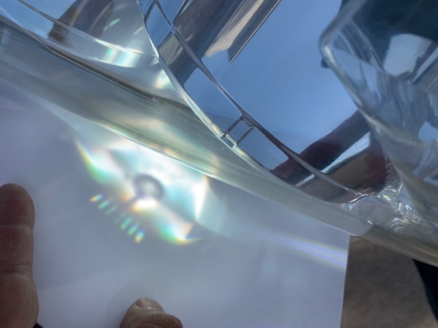

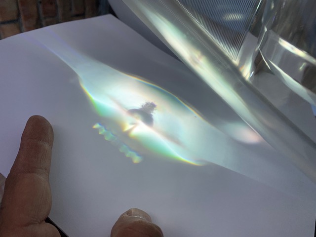

I put a white sheet of paper in front of each headlight and on the passenger side I noticed a black blotch on the bottom of the shadow against the paper, where the round shadow is. The driver side does not have this black blotch. I put a halogen bulb in the passenger side to see if maybe the HID bulb is causing this, but the same black blotch appeared with the halogen bulb. I also blew air in the housing in case it was dirt but it still appears. I am guessing the black blotch isn't supposed to be there??

not all h11 bulbs the same, these cars take the h11b bulbs. there are also h11a bulbs, usually these projectors take H11B.
