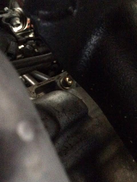

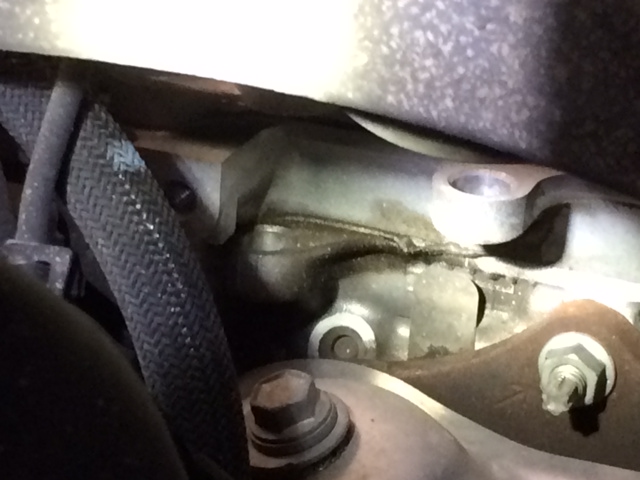

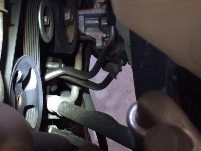

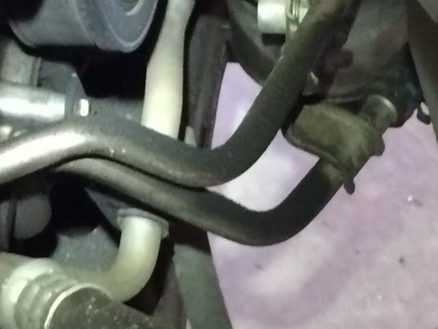

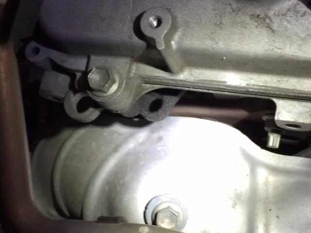

Sure. Here are a few pictures. It was hard to get my iPhone up there, but they give you a general idea. Four of them are various points in the engine where oil has caked up. One is of a bolt in between the two skid plates. I couldn't place it because it was hard to see, but this bolt has fresh oil on it. Probably the lowest point of the vehicle before it drops off.
One note--to me, the first picture showing the oil under the valve covers, it seems that is actually a bit lower than the valve covers...maybe cam seals?

Hmm...that actually doesn't look bad....Did you check the oil level after you found the leaks?
I'm just guessing but wouldn't high pressure result in high engine temp?
Trust me, it is bad. The pictures only capture certain areas I was able to get my iPhone to. The residue, both old and new, is all over the place under the engine.

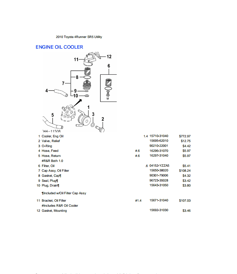

What's this then? Something here doesn't sound right...
Sounded strange to me also but I had no rebuttal ready when he told me this on the phone. Thanks for all of the questions and points. Helping me to build a better case with the dealership I bought the truck at (out of town), the current dealership, and the external warranty provider.
A side question. How often is it that a dealership will sell a non-factory extended warranty (not even offer it) on a new vehicle?
Ok, I called back to get more information. I got it backwards. Mine DOES have an external cooler, so I apologize for miscommunicating that. They were using that as an example of the additional labor necessary to complete the repair.
