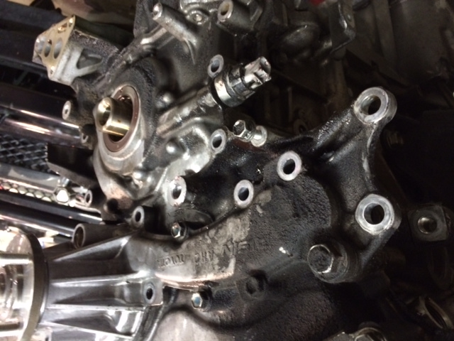

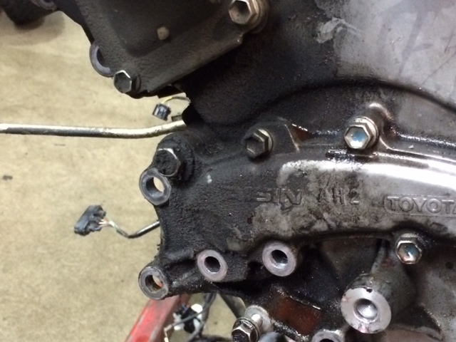

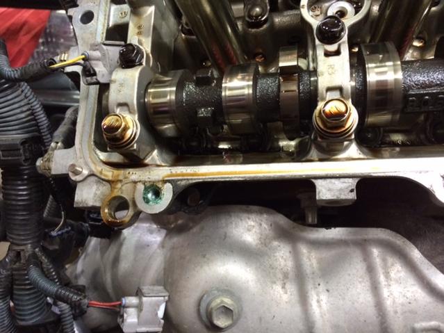

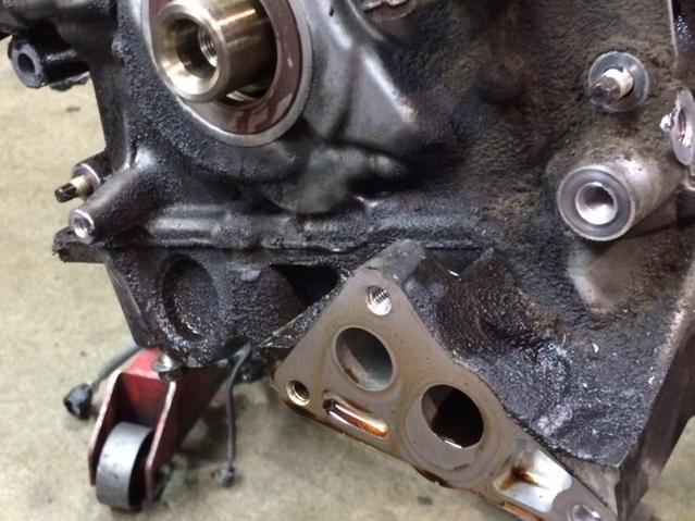

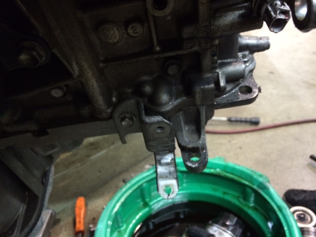

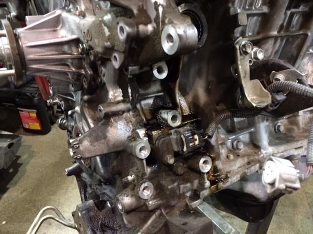

Ok, here are 6 pictures right after the engine came out of the truck. You can see the extent of the oil leaks in all of these pictures (including fresh oil and old residue).
BTW--thankfully, they were somehow able to get the engine out without removing the ARB bumper. No idea how they were able to do that, but at least I was smiling when I saw that.

Thanks for the pictures !
That's been leaking for some time I think. Also agree it is more of a mess than I would have expected from a 2010 toyota.good luck with all
