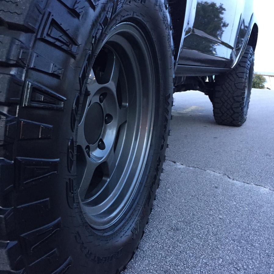

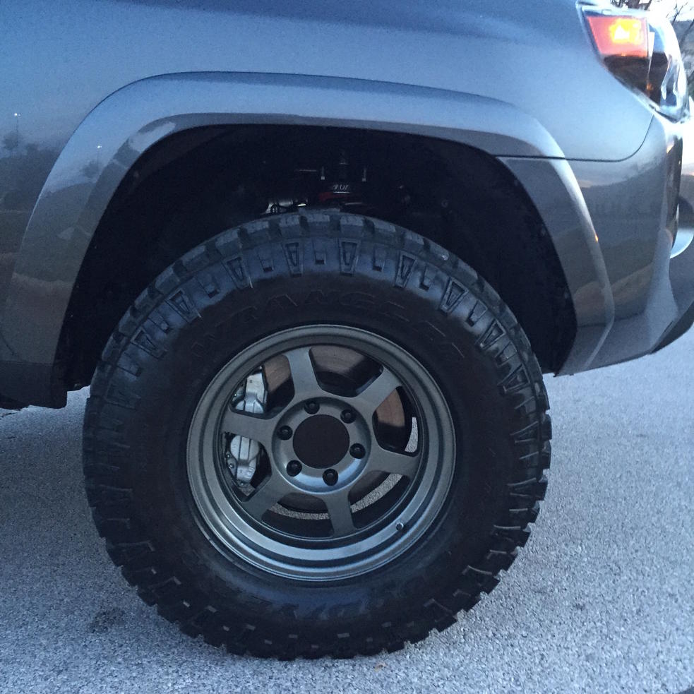

What rims / offset?
17 x 8 , -10 offset :embarassed: , [MENTION=85422]FNWheels[/MENTION] Countersteer Type X. I'll sacrifice a little plastic for the stance. :shrug:
