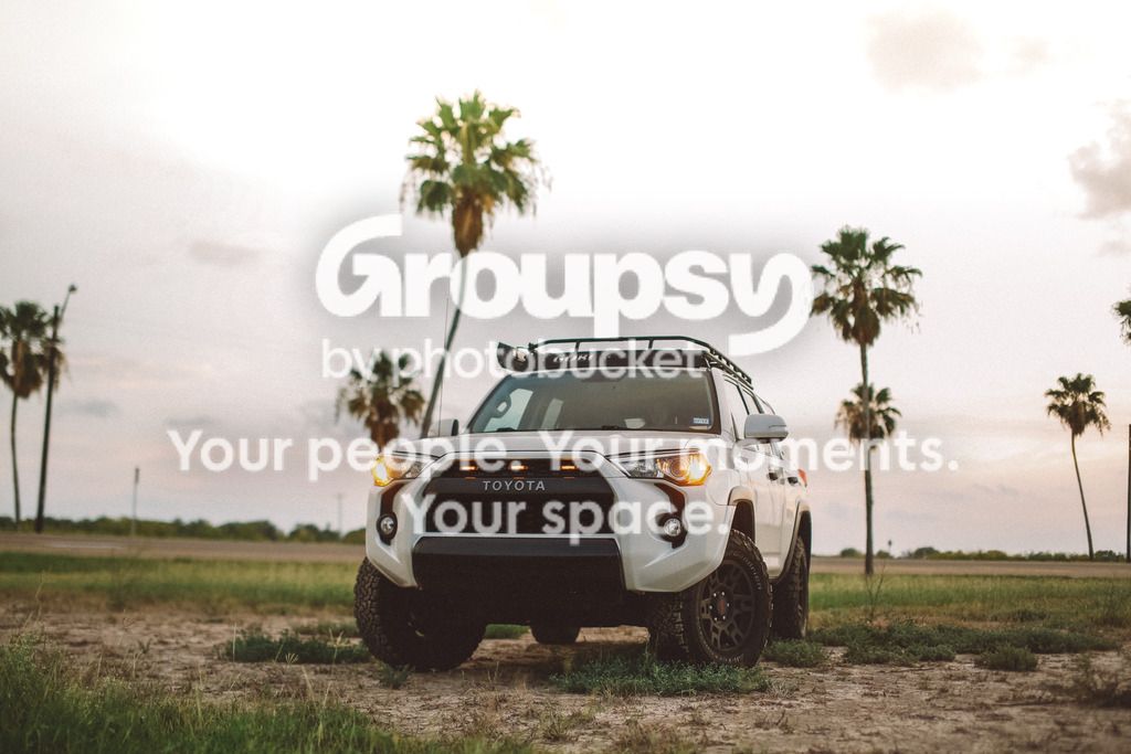

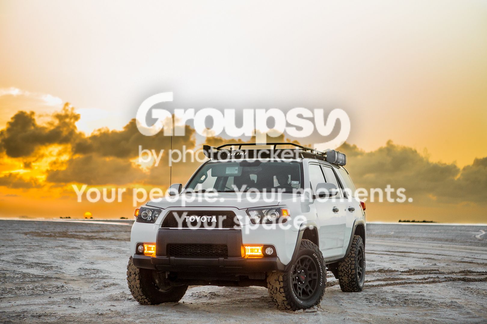

So about 5 years ago I did a trail conversion on my pearl white SR5. Then Ive been itching to get the new muscular front end. Finally its done and here is the parts list for 2014 conversion. Pretty self explanatory as far as installation goes, remove the old and slap on the new parts. This will benefit those with metal bumpers that have OEM bumpers collecting dust and those who want to upgrade to the new front end.

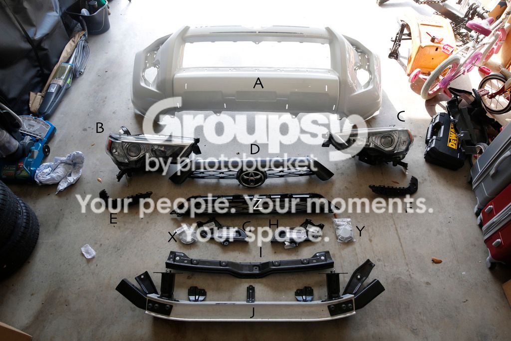

parts A,E,F,I AND J, I purchased from someone with a TRDPRO who went with a proline metal bumper. purchase price for this was $500 to give you guys an idea.
The OEM headlights I purchased from ebay for $250shipped and Part D from ebay for $99 shipped. parts X and Y are dust cap for the headlights.
jeffy did a write up on the headlight conversion here: 2014+ Facelift (headlight swap) - Toyota 120 Platforms Forum
the rest of the parts i purchased from https://toyotaonlineparts.mcgeorgetoyota.com this was the cheapest place I found parts listed for.
The fender liner I purchased from ebay for about $100 for both, you can cut your OEM to save some money.
my total cost for this was about $1,100 give or take a few dollars.
TIPS: buy used! lots of people now have metal bumpers with OEM bumpers and brackets laying around. search ebay for parts. DM me for questions or message me on IG @coconut4runner for quicker response. :cheers:
A. bumper
TOYOTA# (52119-35914) trail edition $189.73
https://parts.mcgeorgetoyota.com/oe...1bm5lciZ5PTIwMTYmdD10cmFpbCZlPTQtMGwtdjYtZ2Fz
B. Headlamp, RIGHT
TOYOTA# (81130-35541) $219.62
https://parts.mcgeorgetoyota.com/oem-parts/toyota-composite-assembly-8113035541
C. Headlamp, LEFT
TOYOTA #(81170-35571) $219.62
https://parts.mcgeorgetoyota.com/oem-parts/toyota-composite-assembly-8117035571
D. upper grill surround (CHECK SITE FOR COLOR SPECIFIC)
TOYOTA# (PZ327-35054-E0) $116.81
https://parts.mcgeorgetoyota.com/oem-parts/toyota-grille-radiator-oute-pz32735054e0
Z. upper grill (TRDPRO UPPER GRILL)
TOYOTA# (PZ327-35053) $157.92
https://parts.mcgeorgetoyota.com/oe...iator-upper-in-stock-ready-to-ship-pz32735053
TRD PRO 4Runner Front Grill Garnish (TOYOTA) (PZ323-35056) not pictured
https://trdparts4u.toyotaofdallas.com/Scripts/prodView.asp?idproduct=-10417
brackets
G. Support Bracket, RIGHT
TOYOTA# (52102-35100) $34.05
https://parts.mcgeorgetoyota.com/oe...uZXImeT0yMDE2JnQ9dHJhaWwmZT00LTBsLXY2LWdhcw==
H. Support Bracket, LEFT
TOYOTA# (52103-35110) $33.84
E. Side Retainer
Toyota# (52115-35150) right $31.26
F. Side Retainer
Toyota# (52116-35150) left $31.26
I. Center Support - Toyota# (52521-35060) $40.61
J. Reinforcement - Toyota# (52021-35140) $252.12
Rail Extension - Toyota# (52026-60050)
Rail Extension - Toyota# (52025-60050)
FENDER LINER, RIGHT - 2015 TOYOTA 4RUNNER (5380535030
https://toyotaparts.mcgeorgetoyota....s-scat/?part_name=fender-liner&position=right
FENDER LINER, LEFT - 2015 TOYOTA 4RUNNER (5380635030)
https://toyotaparts.mcgeorgetoyota....ts-scat/?part_name=fender-liner&position=left
BUMPER COVER RETAINER, RIGHT - 2015 TOYOTA 4RUNNER (5387958010)
BUMPER COVER RETAINER, LEFT - 2015 TOYOTA 4RUNNER (5387958010)

For the trd pro grille. I see you bought the upper grille but what about the black Toyota cover piece that sticks on?
I bought a used trdpro front bumper so it came with that piece already. I added the part number and link for it incase anyone needs it.
This is awesome. I love the look of the new TRD Pros, but want the features of my limited. May have to tackle this if ii find a Pro bumper for a decent price. What did you end up doing with the lower amber DRLs from your original bumper? Is it obsolete after the conversion? Also, are the new headlights just plug and play with the original harness?
the DRL from my old bumper goes up next to the headlight and becomes my DRL and signal lights. The new headlights are not plug play as far as the harness goes because the actual headlight housing comes with a little little harness that attaches to the h11 bulb but the other end of it which attaches to the vehicle isn't h11. Im not sure what it is but the easiest way around this is to either splice it or get a HID kit which most people are already doing.

Are these two pieces removable? Do I have to order the whole bumper aka part A in the picture (52119-35914)? Ideally, I want to replace just the silver piece in the picture but without the license plate bracket with a black version.
What about the rear piece? Do people typically just get both of the above painted black or what?
I am a brand new T4R owner so excuse my noobiness.
I have a question....
You need these Front and rear valance :
For Silver Version (TRD Off-Road)
53901-35240
52169-35110
For Black Version (TRD PRO Style)
53901-35250
52169-35120
