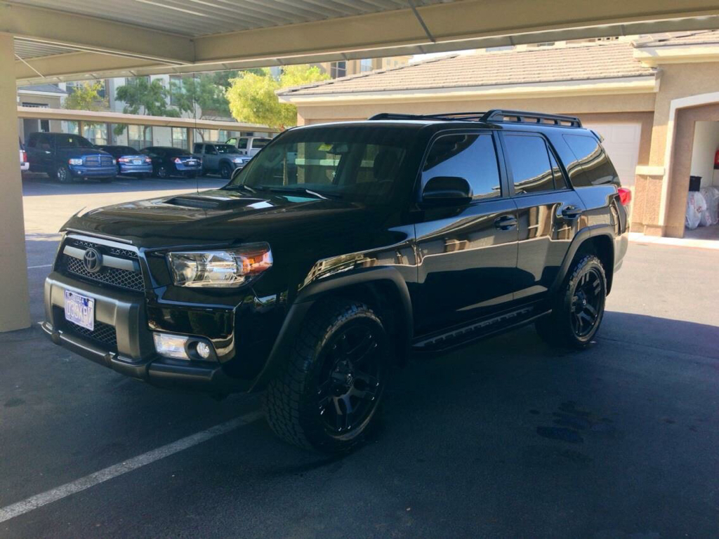

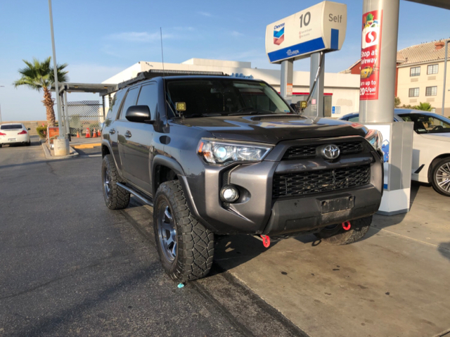

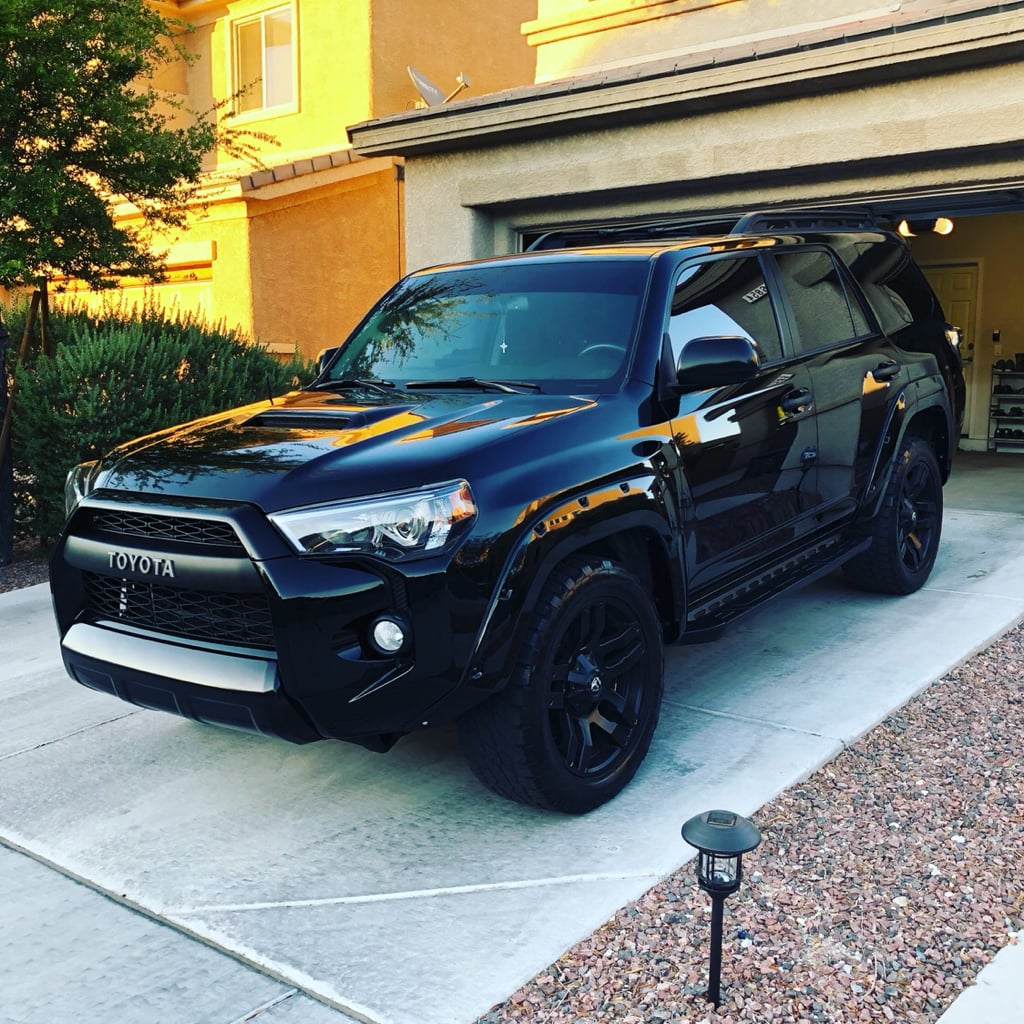

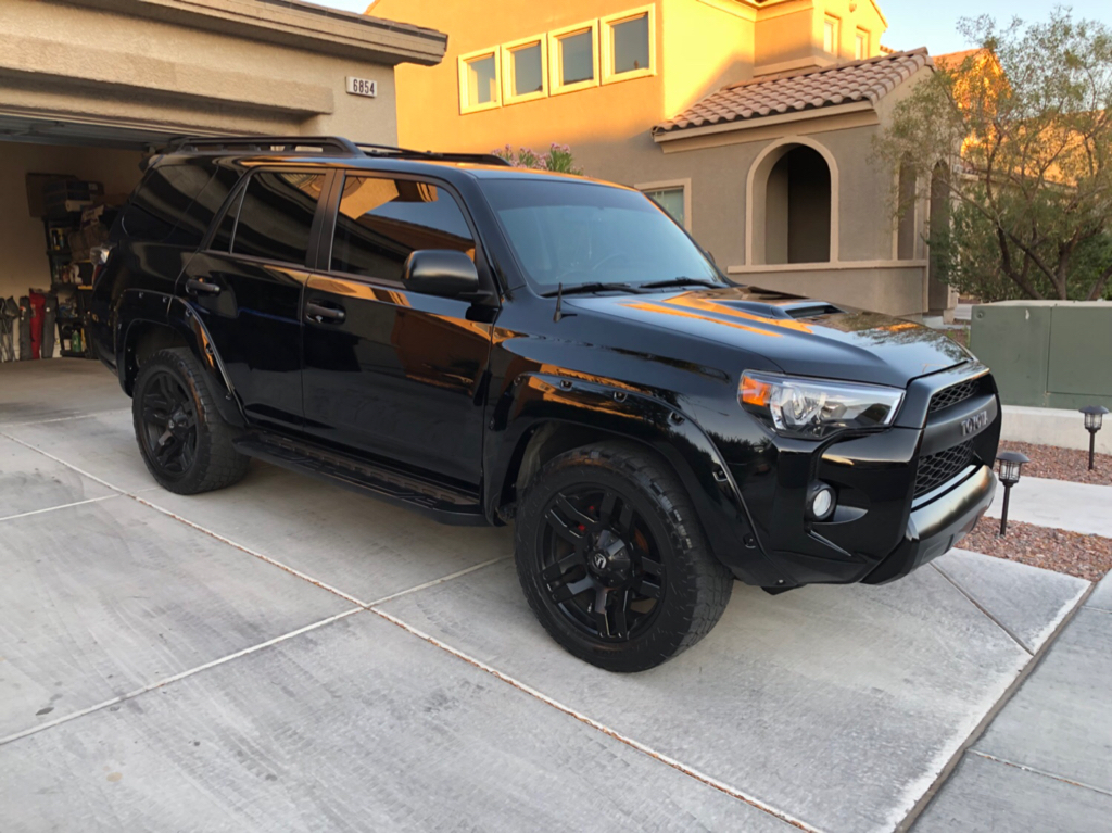

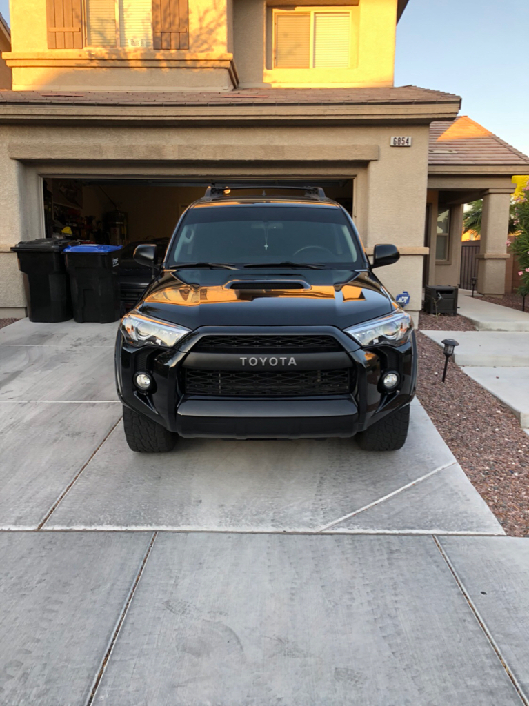

Here is mine converted. I got lucky to find someone that wanted the pre-face lift front end.
Before:
f809d59998491dcfbdc98fa951fb6a94.heic
During:
After:
Now waiting on a lowpro bumper to complete it.
Any issues with gap between new headlights and the hood? I've got a '14 that I'm actually looking to swap for the older front. Something about the previous front just sings to me more than the aggressiveness of the newer one.
Before:
During:
After:
I'm thinking about doing this as well... did you wind up painting the parts around the wheel well that went from black to the mag gray? Mine is silver so it would be much more noticeable and drive me nuts.
Yes i plastidip the bumper trim to match the fender flares.

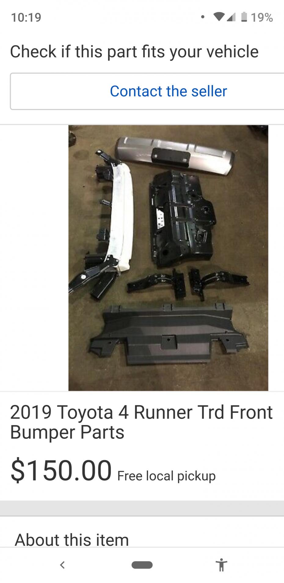

Still can't believe I scored on this eBay yesterday. Was a local pick-up only, but actually had a buddy that lived 35 minute away and passed the place going to work every day. Picked up and getting shipped to my home...2011 front end conversion is getting close...close...close ...
Doh!
I guess I shouldn't have scrapped those bumper parts when I added my Warn winch bumper.

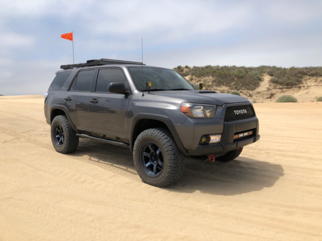

I find this thread rather amusing because up until last winter I had a '10 TE. The whole time I had it I thought the front end, rear bumper, roof rack, wheels, etc... the whole package was way better looking that. Then I got stupid and had to get my "dream Jeep"... 2020 Wrangler Unlimited Rubicon... and sold my 4Runner. I ended up not loving the Jeep and missing the Runner, so now I have a '20 ORP. I love it. BUT I wish it looked like the '10 TE.
