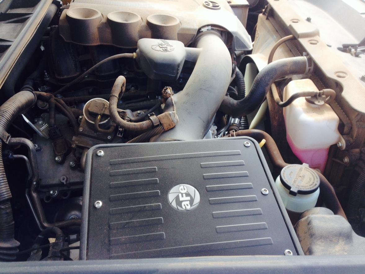

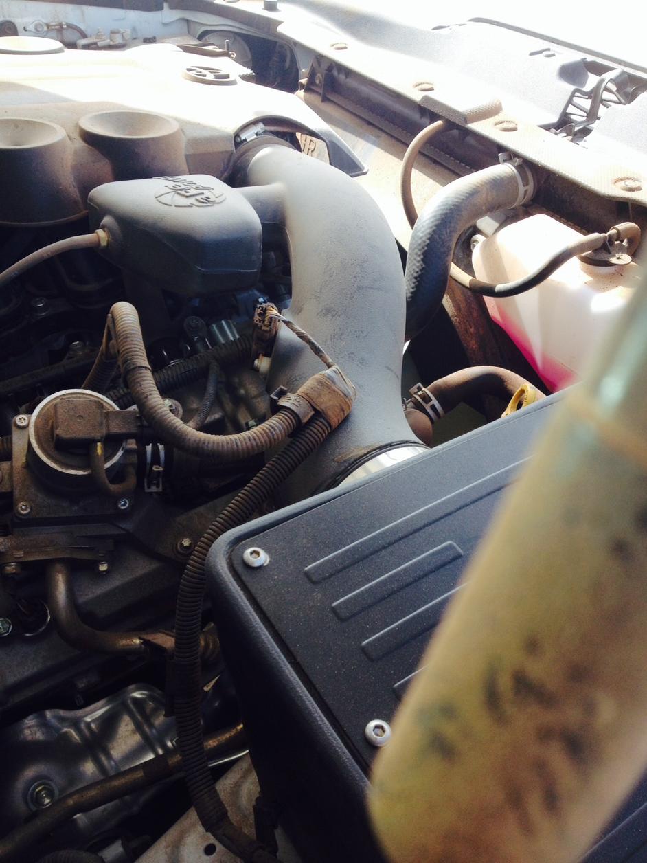

I don't know if this helps or not but I have a 2012 AFE in my 2014. I had to reverse the horn bracket on the fender well but otherwise it was a direct fit. Sorry for the poor pictures.
