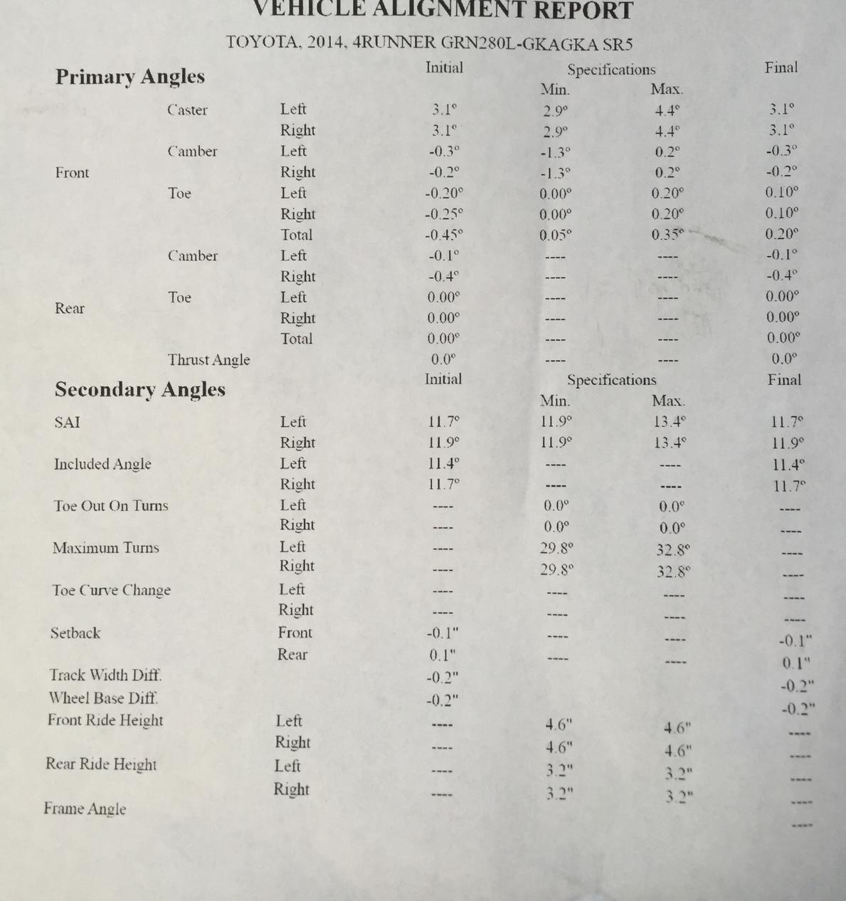

Just had new BFG KO2's installed so i had an alignment. After i received my before and after Specs i noticed they used 2014 SR5 specs on my 2013. Are they the same? I know we have the same frame but after looking at my 2010 pdf service manual they use the body number GRN280L and mine is a GRN285L. According to the manual specs differ? They adjusted my toe in to .10 right and .10 left for a total toe of .20? Take it back?
Same frame. Same suspension. Same body with very few exceptions. Same engine. Different interior same dimensions. Same alignment specs.
They used a 2WD vehicle for the alignment specifications, though I don't think the specifications are actually that much different.
I wouldn't be too concerned that they used a 2WD vehicle or that they used a 2014 specification sheet (the 2013 specifications are identical.)
GRN280L SR5 Camber: (-0.58° +/-0.75°)
GRN285L SR5 Camber: (0.00°+/-0.75°)
GRN280L SR5 Caster: (3.67° +/-0.75°)
GRN285L SR5 Caster: (3.22° +/-0.75°)
Here it is, thanks for the help!!
