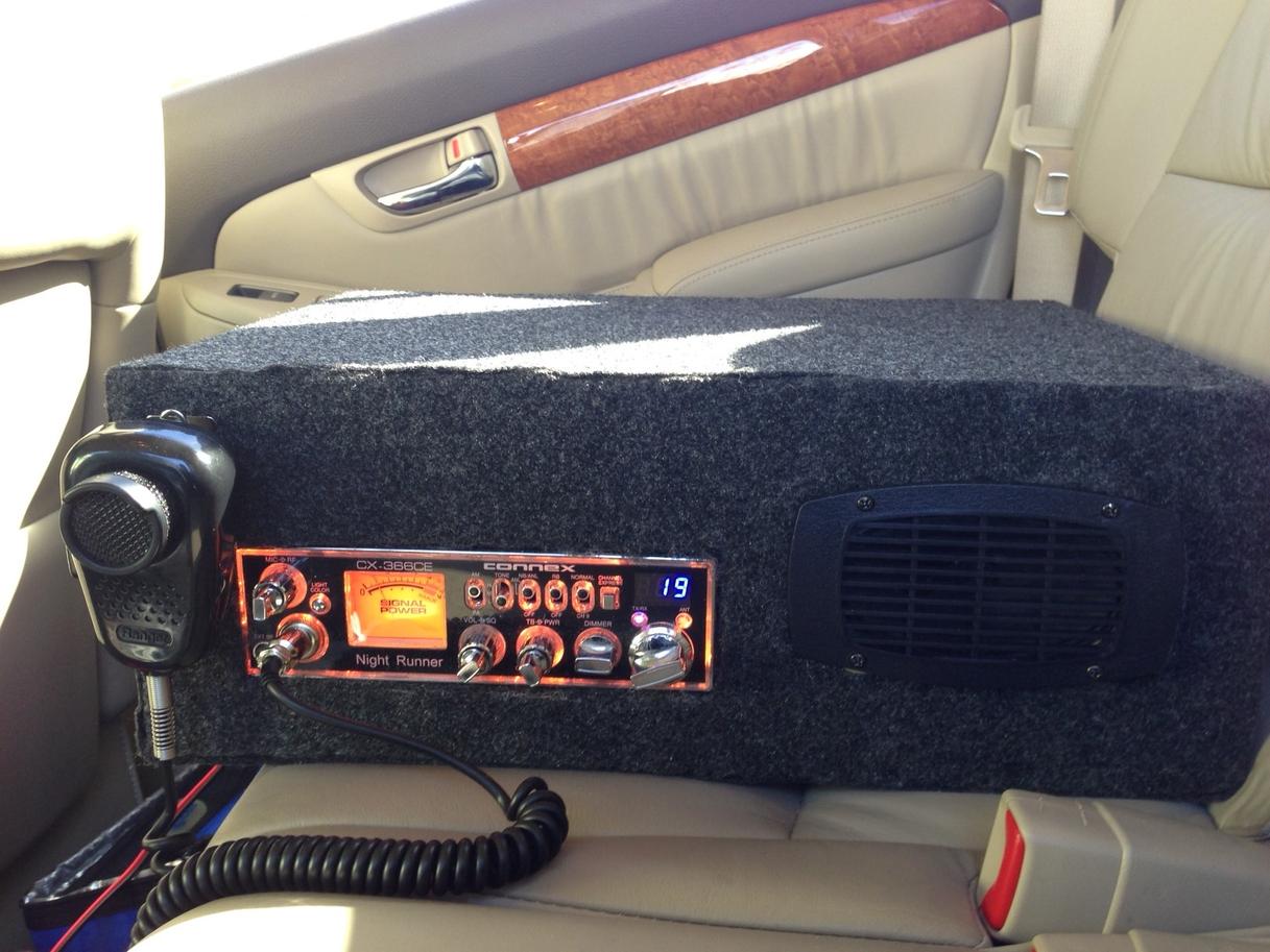

What I ended up doing was building a small "slip-seat" box containing my radio, mount for the mic, and an external speaker. It's about the size of a briefcase and made out of 5/8" particle board I had laying around and covered with sub box carpeting. Not ideal but fits perfect facing me on the front passenger seat when solo or on the backseat when the gf is with me. The back opens to make the power and antenna connections. Right now it's riding in my GX till I get my T4R and pictured on the rear seat passenger seat. I need to figure out a better way to secure it, right now the seat belts have done a good job but something like a carabiner somewhere on top to attach to the belt would be better.
