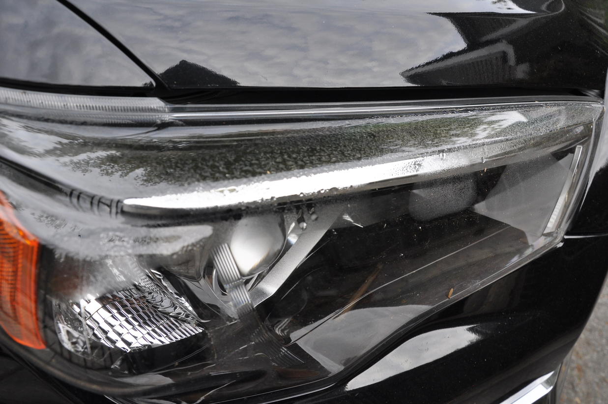

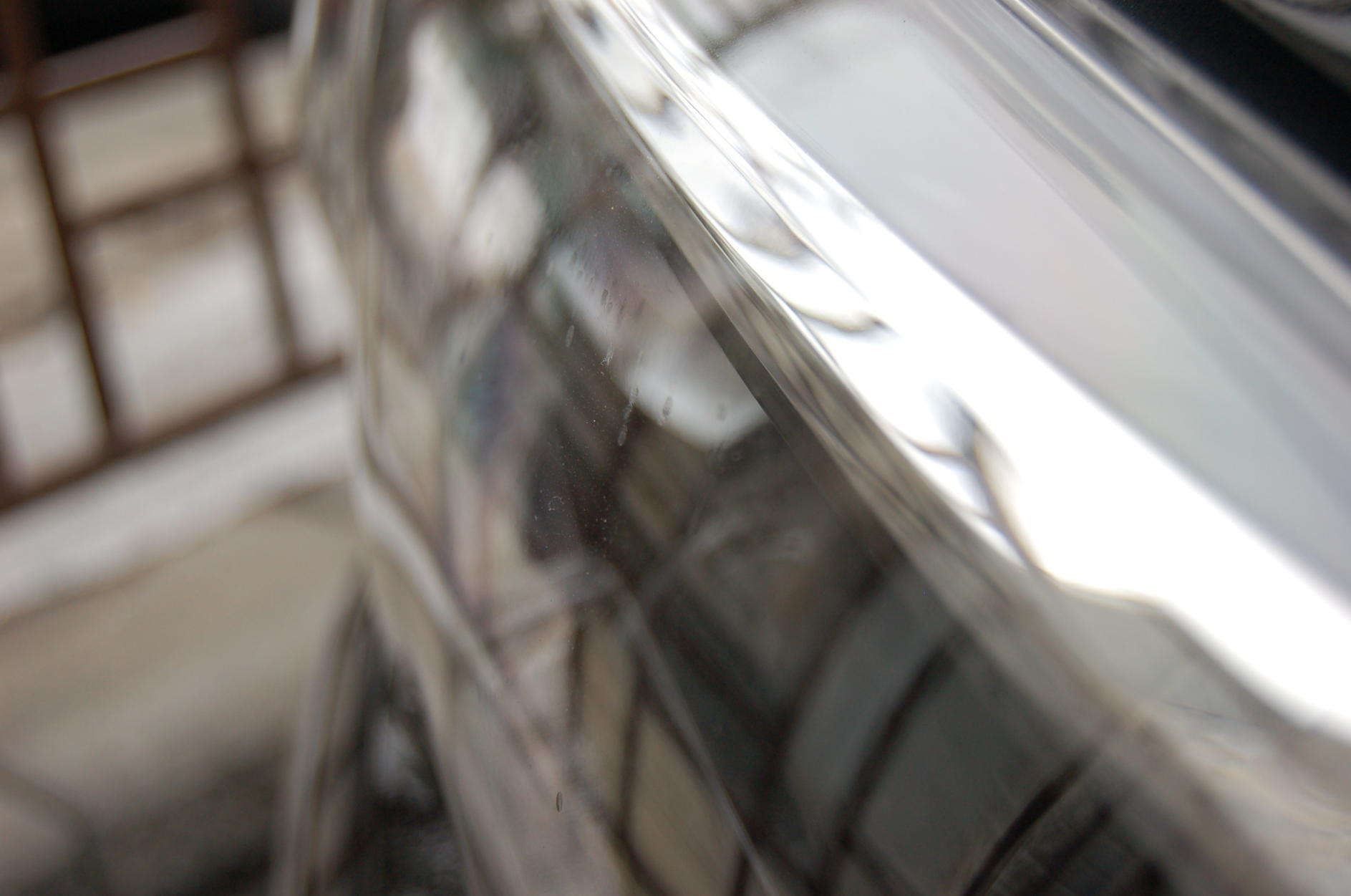

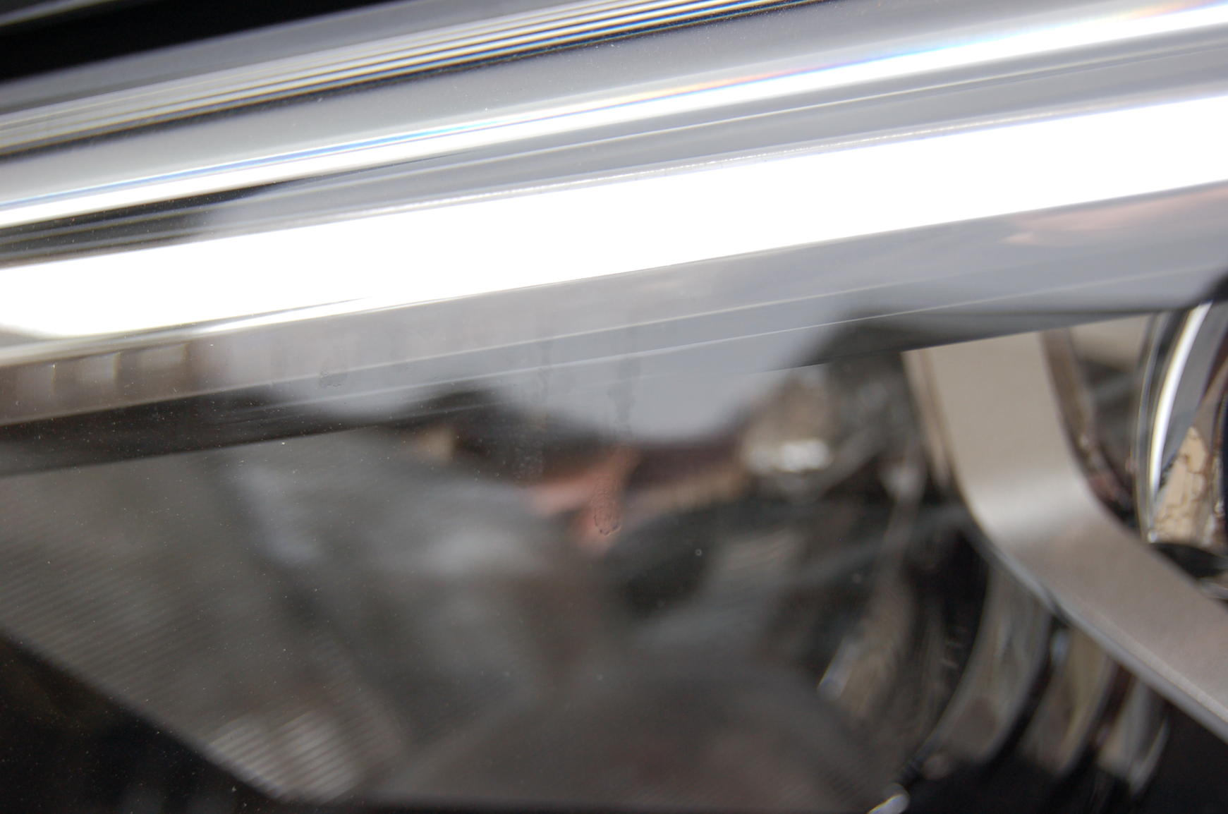

Just noticed this while hand washing the truck for first time: the insides of the headlights on both sides are stained with what appears to be something resembling tears on the top, front edge, as though there was frost inside and it melted, then dried. Not seriously noticeable, as you can tell from pics, it's hard to see, but something is wrong here. I am running H9 bulbs but seriously doubt that would cause this. Any suggestions? (Sorry about the large pics but it helps to see the issue.)

There have been reports of some leaking. That looks like condensation that dried leaving a residue. Ask the dealer to replace them. Unless your H9 upgrade left some air gap?

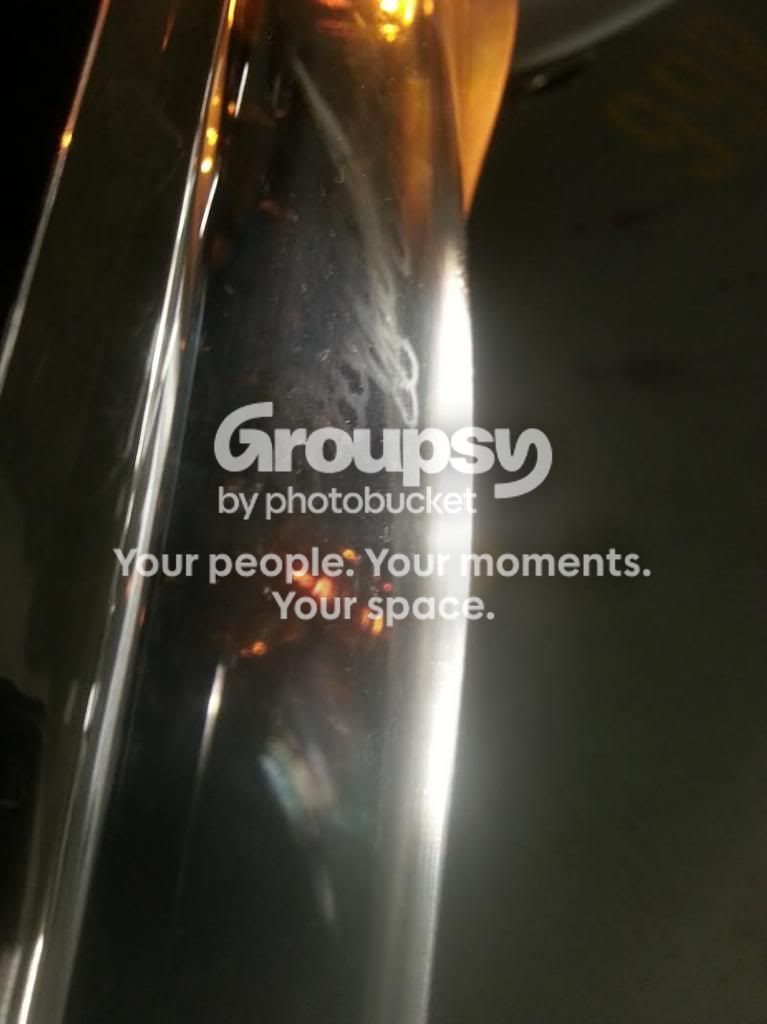

got it too
unnamed_zpse2e7eb63.jpg~original
After reading this thread I checked mine the other day, they look to have some sort of mist in them, maybe condensation.

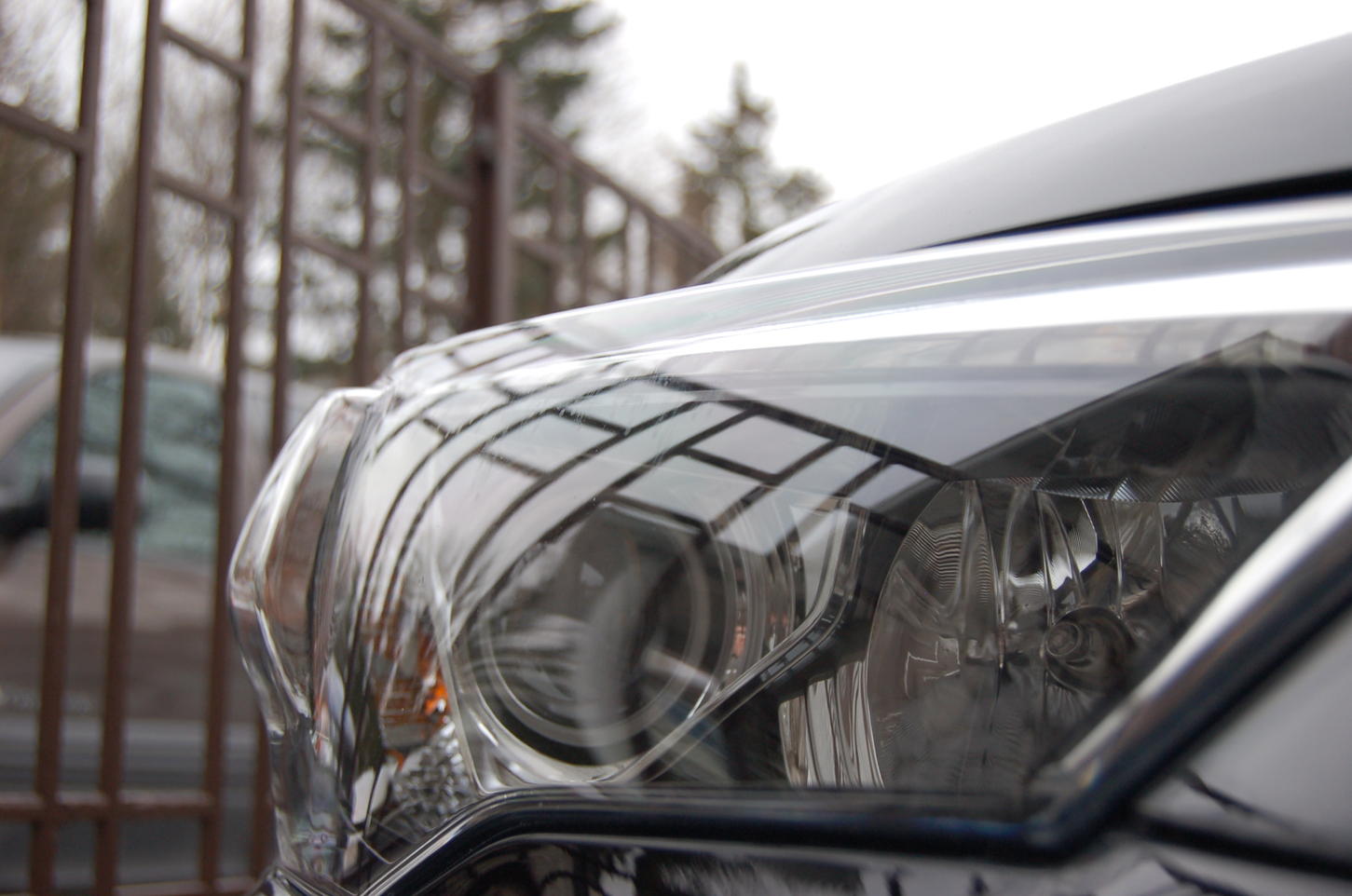

Goes to dealer tomorrow for headlamp replacement, both sides, under warranty. Dealer didn't even hesitate, took one look, ordered new ones.

Thanks SC, it's actually much worse than that - took the pic on a good day.
Yes, putting stock bulbs in today. Hoping, of course, nothing gets messed up in the swap. Will be shocked if it all gets done perfectly without new damage.
