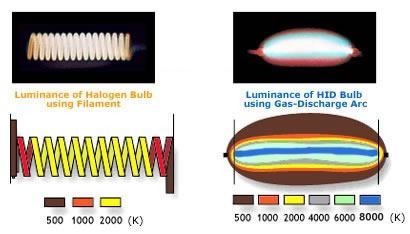

Although I'm now 100% convinced that you aren't looking for "facts" based on your support of vague anecdotes, I will post this picture:
As you can probably see, the bulbs are not the same shape or design, light is not emitted from the exact same points, and light is not restricted from the same areas at the same angles. I really don't know what other types of facts you're looking for on this subject. Do you understand how lighting works in headlights? I am not trying to belittle anyone, but it seems you might not understand the actual concept. The vast majority of the light thrown forward is actually light being reflected from the rear bowl, not from the bulb going directly forward. The purpose of the bowl is to take a limited amount of light from a specific bulb at a specific focal point and essentially magnify what you see in front. It does this at nearly infinite angles on half of the bowl from the rear using light which would otherwise be "lost" since it was going backward.
Oh, and just because a cutoff "looks fine", doesn't mean it actually is. You would really need to measure the amount of light at several points above the cutoff on both before/after to prove that it is just as safe as the old setup. Eyeball test of a couple of people doesn't work here. I apologize for the physical geometry that concludes you can't drop in a "PNP HID kit" and have better light with no drawbacks. Sorry.
