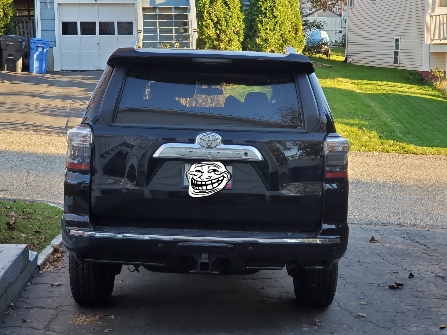

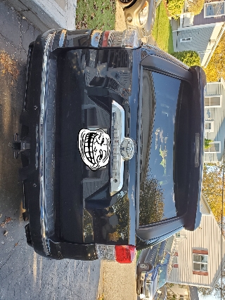

Added the new TYC tail lights with both part numbers ending in 00. No extra harness needed, true plug and play.
just purchased the TYC taillight...hope i can do it myself

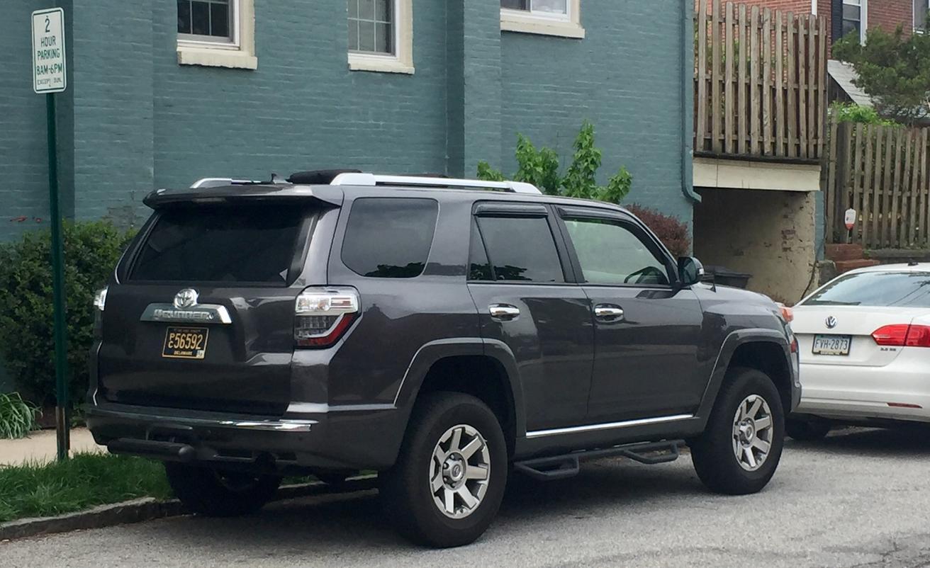

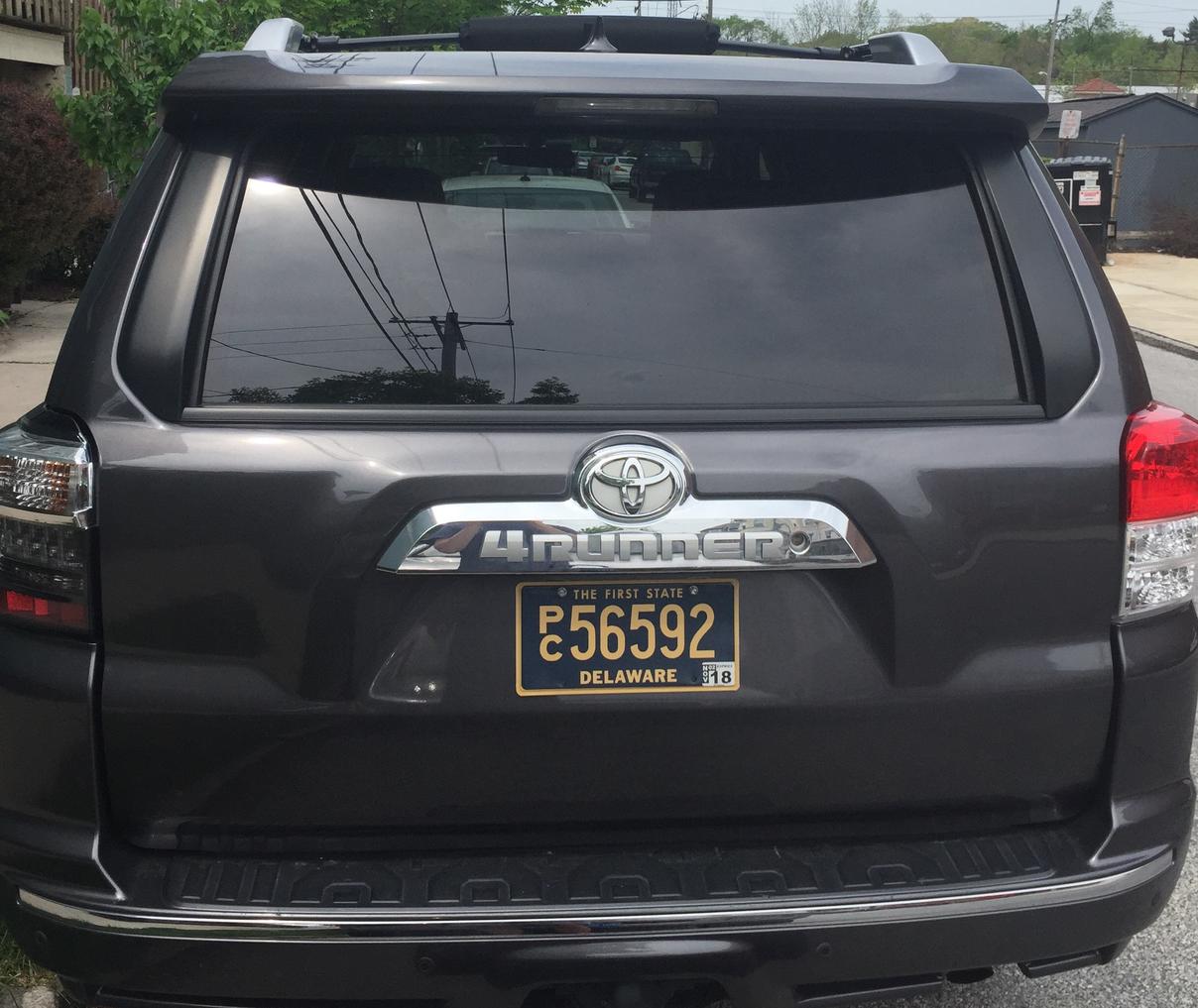

Love this forum because of it i had the confidence to get into a 2010 4Runner. Few days later bought used headlights and taillights from a kid who bought aftermarket black housing ones for his 2019. A day later picked up my harnessed from the dealer and now I'm trolling. Got a 2010-2013 front end with a newer back end lol.
