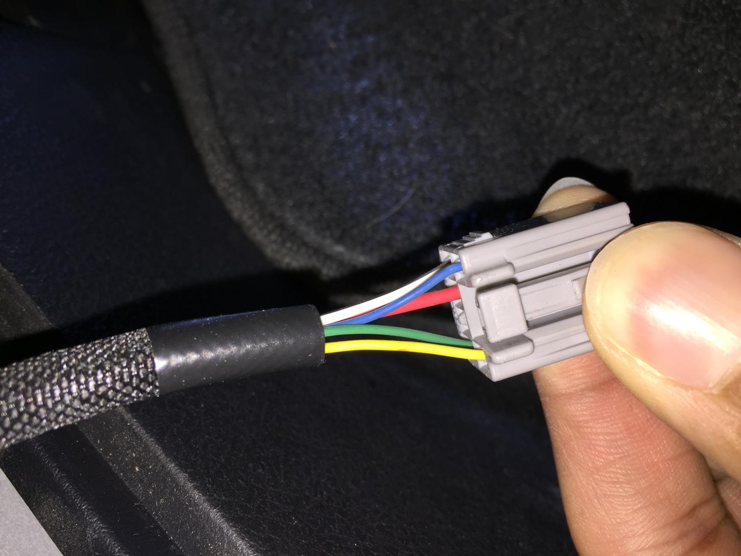

Thanks. I'll do that. As far as the resistor is concerned which two wires does it go on?

Could soemone please tell me which two wires in the picture above that I should put the resistor on? I'm not sure which and don't want to put it on the wrong wries.
Thanks in advance!

I posted last night about the LED turn signal light. No response yet. I don't want to splice a wire if I don't have to. Also, I don't know which wires to splice. The picture I posted above is my harness and it has more than two wires. Plus it's plugged into the harness for the 2014 tail light. So I'm at a loss for what to do.

The two wires you need to use the resistor on would be between the white/black stripe and the yellow wires. This would create the extra load on the turn signal circuit. You would tap into each wire, the resistor does not go in-line with them.

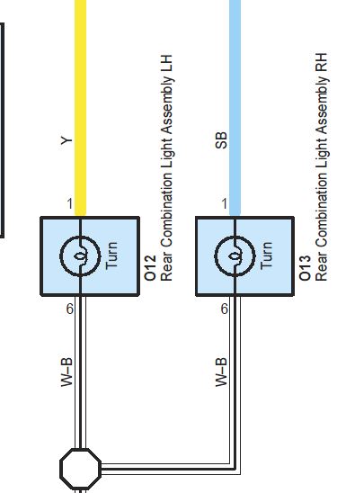

Looked at the wiring schematic to confirm, it may be light blue on the right side, left side should be yellow. When you pull the lamps out you'll be able to tell if it is light blue instead of yellow on the right.
Looked at the wiring schematic to confirm, it may be SKY blue on the right side, left side should be yellow. When you pull the lamps out you'll be able to tell if it is sky blue instead of yellow on the right.
So to confirm I would tap into the white/black and the yellow on the left.
Tap into white/black and blue on the right.
Correct?
That would be correct, but if you'd like to make absolutely sure, put turn signals on and check the yellow and sky blue wires for a 12 volt pulse with either a test light or a multimeter.

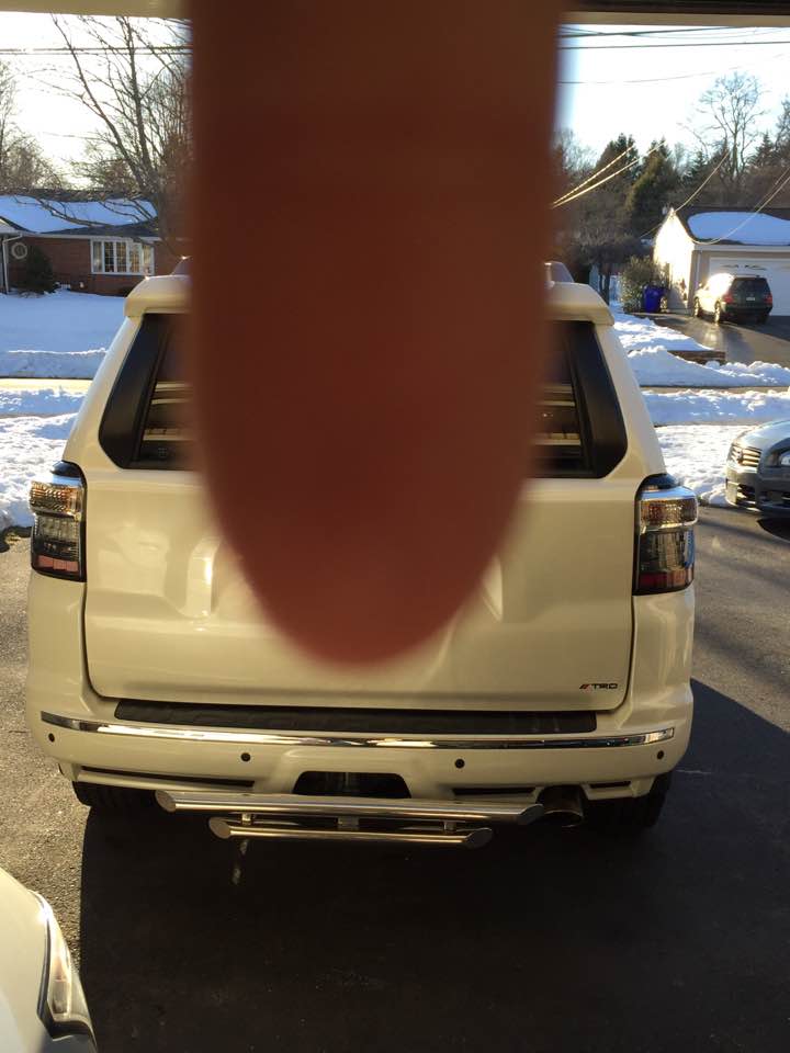

Finished installing the 2014+ LED taillights today. I'm very happy with the upgrade. Wish I did it a long time ago.

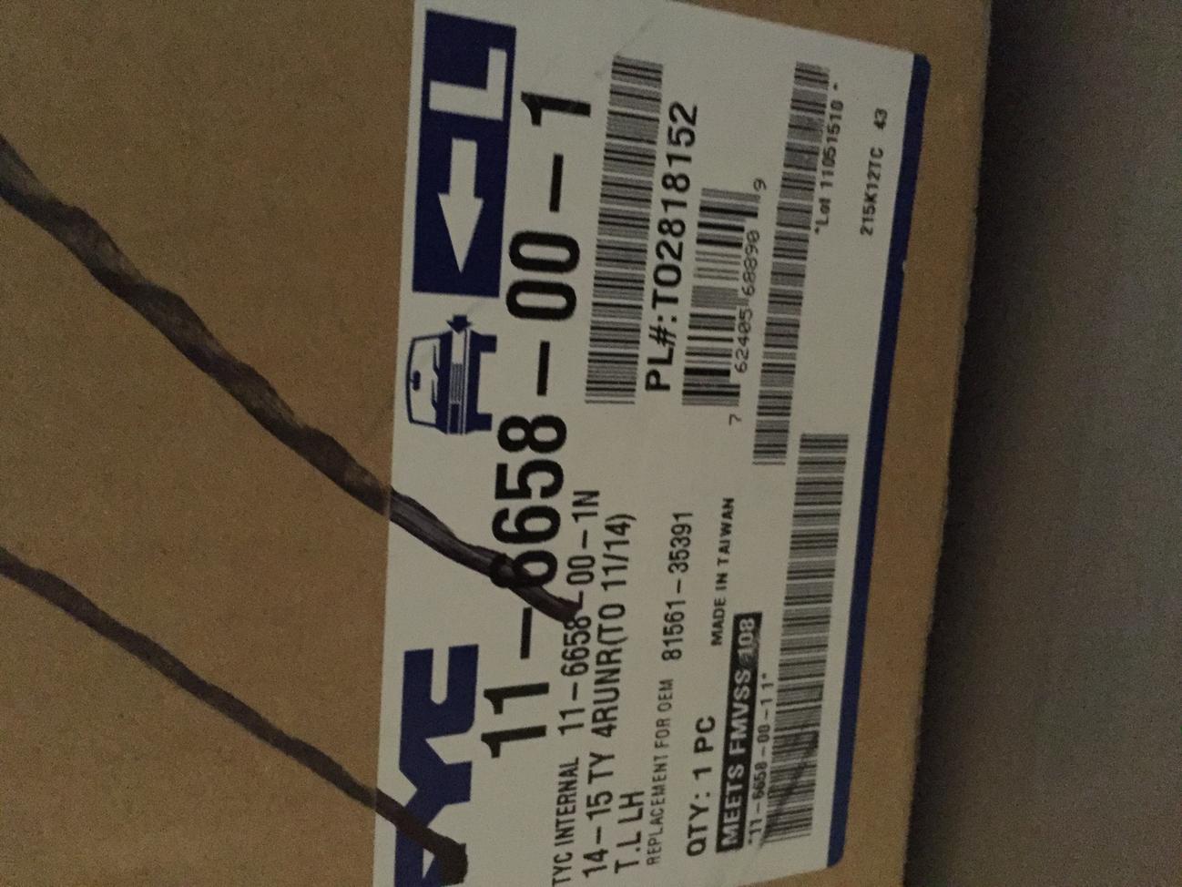

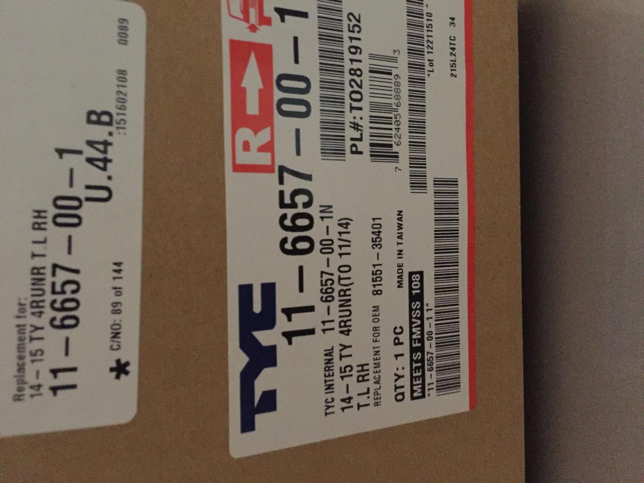

TYC part numbers- direct plug and play
So here are the TYC part numbers for the direct swap. The most important numbers here are the -00- which signifies that no harness is necessary and it is a plug and play conversion. I love my 2014+ tail light swap. LEDS in the reverse and turn signals would be great. That may be the next thing I do since I'm almost all LEDs around the truck.
