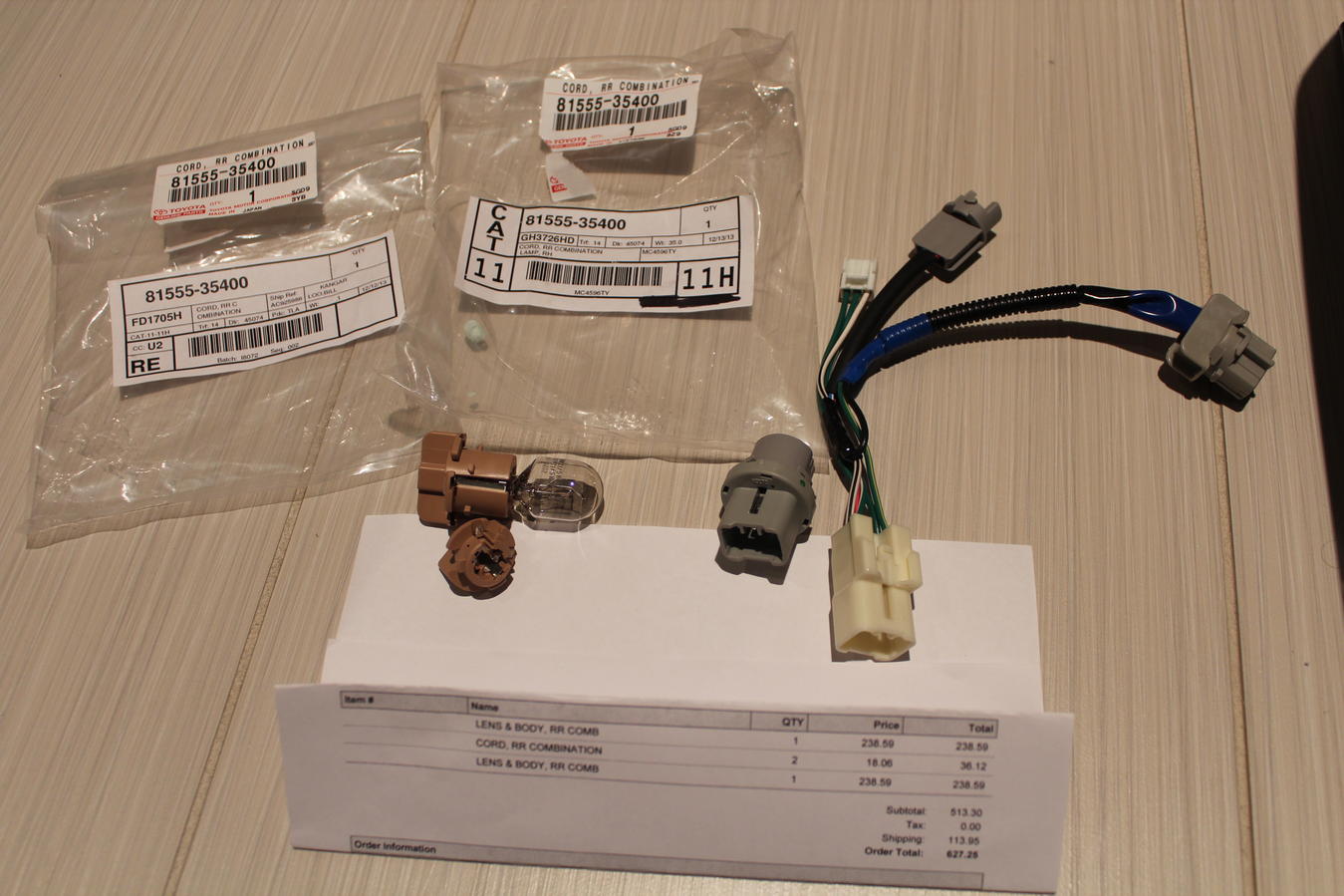

The listing on ebay does not include the 2 sub-harnesses needed to make the '14 tail lamps work on a '10-'13 4Runner. This has been discussed at length in 2 seperate threads. I even went thru the trouble of going to a Toyota dealership that had a sub-harness and I posted pics of it in this thread. The pic clearly shows the part #'s (which I provided a long tima ago) and I have thoroughly described the sub-harnesses on 3 different occasions. YOU DO NOT NEED TO BUY SOCKETS!!!! The sub-harnesses contain 2 sockets that should accept 2 of the existing 3 bulbs on any '10-'13 4Runner. If not, finding the correct bulbs is a no brainer.

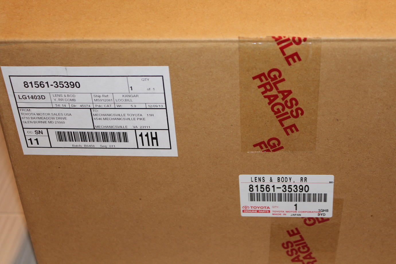

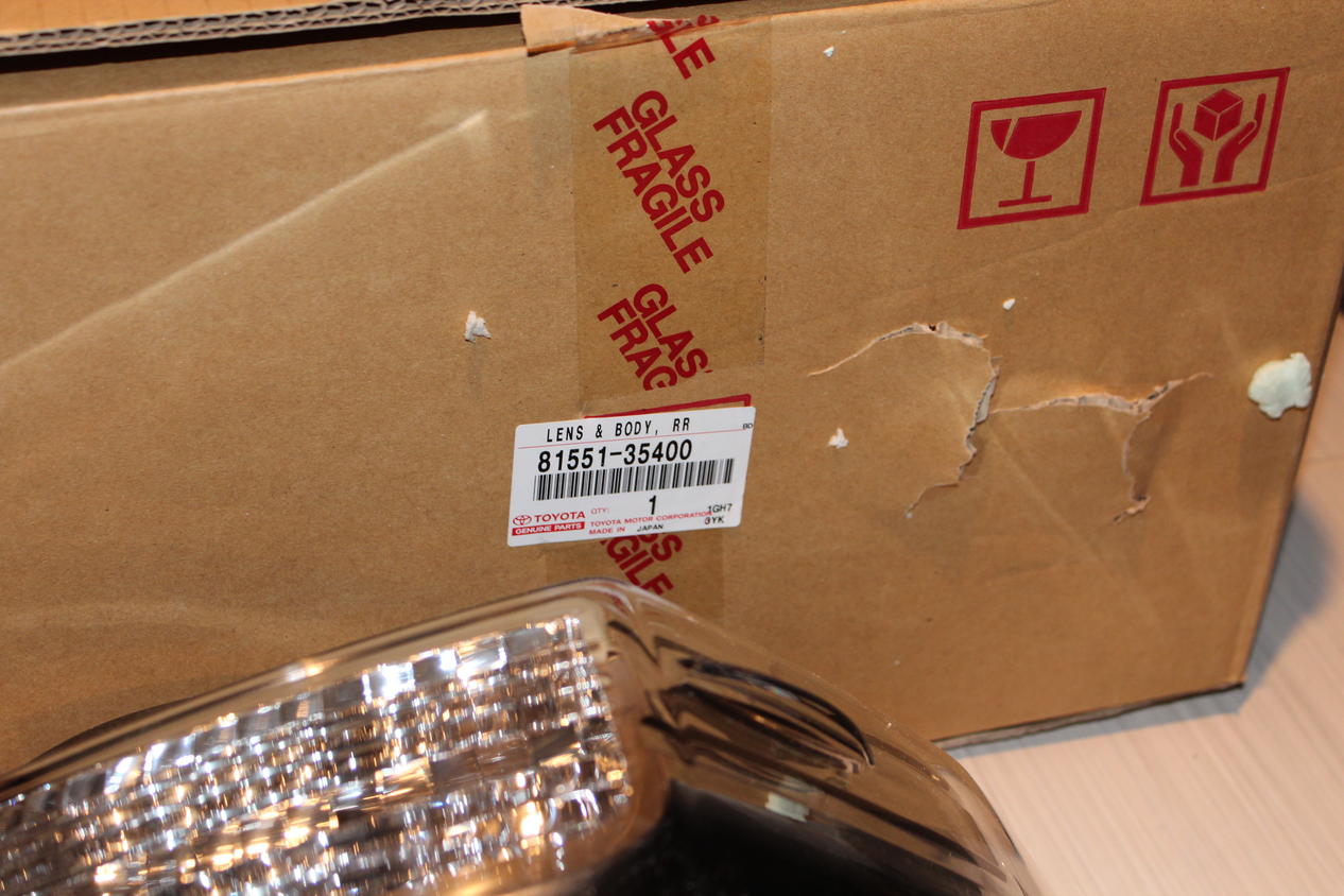

Ordered the tail lights, part numbers from page two of this thread, and the two wire harnesses that the first guy that did the swap posted.
Right= 81551-35400
Left= 81561-35390
harnesses: 8155535400
So as I understand, once received, this is all I need to do the swap and everything is l

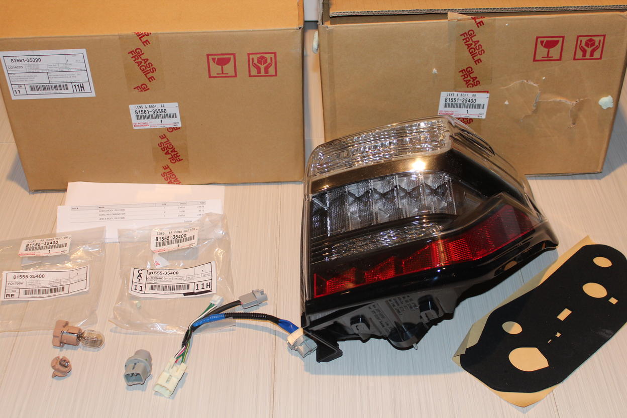

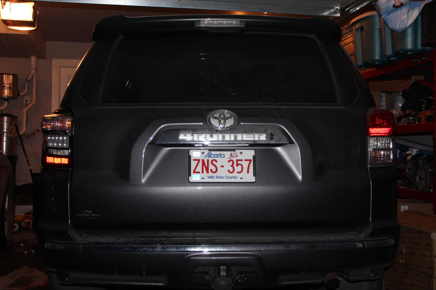

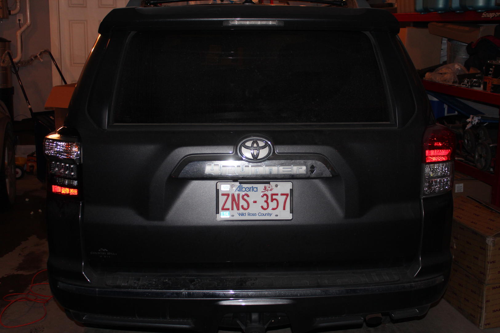

I just completed this mod. Thanks to the info and part#s posted by N2GLOCK the switch-over was easy. If you order the parts you have listed the rest is P&P, the 2014 harness will replace the 2010 sockets and you can reuse your 2010 bulbs (you don't need the brake bulb as that is now LED). In the pic below I have the 2010 sockets on the left for ref. I ordered my parts from Mid Atlantic Toyota parts as they ship to Canada.
Hope this clears-up any remaining questions.

Thank you BKRunner for all the details, yes this clears things up. Looking at the pictures, I just can't wait to receive the lights, due for the 7th of january :).
Looks extremely good on you truck!!
