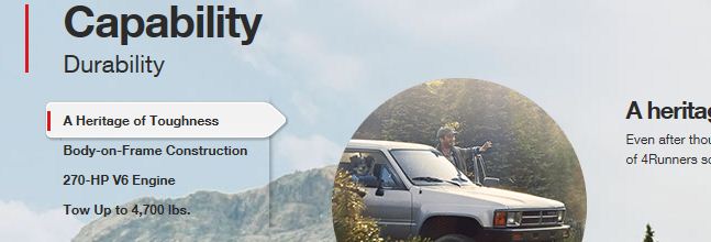

Oh please, allow me to spoon-feed you. This took 15 sec on toy.com. sheesh. Carry on.
Are you suggesting that some here-today, gone-tomorrow website holds more weight than the owner's manual that came with the vehicle?
And, since you're obviously not following, I already stated that the website listed the limit at 4700#. That's what started this whol thread. So explain how you telling me something I already knew is spoon-feeding me exactly?
