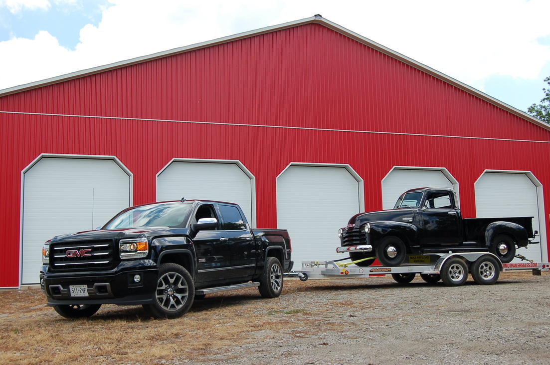

This trailer was about 900 lbs. The old feller on board was less than 4,000.
If I didn't have mirrors, wouldn't have known there was anything out back, was even running in four-cylinder-mode. Steel trailer would have added another layer of uncomfortable variables.
