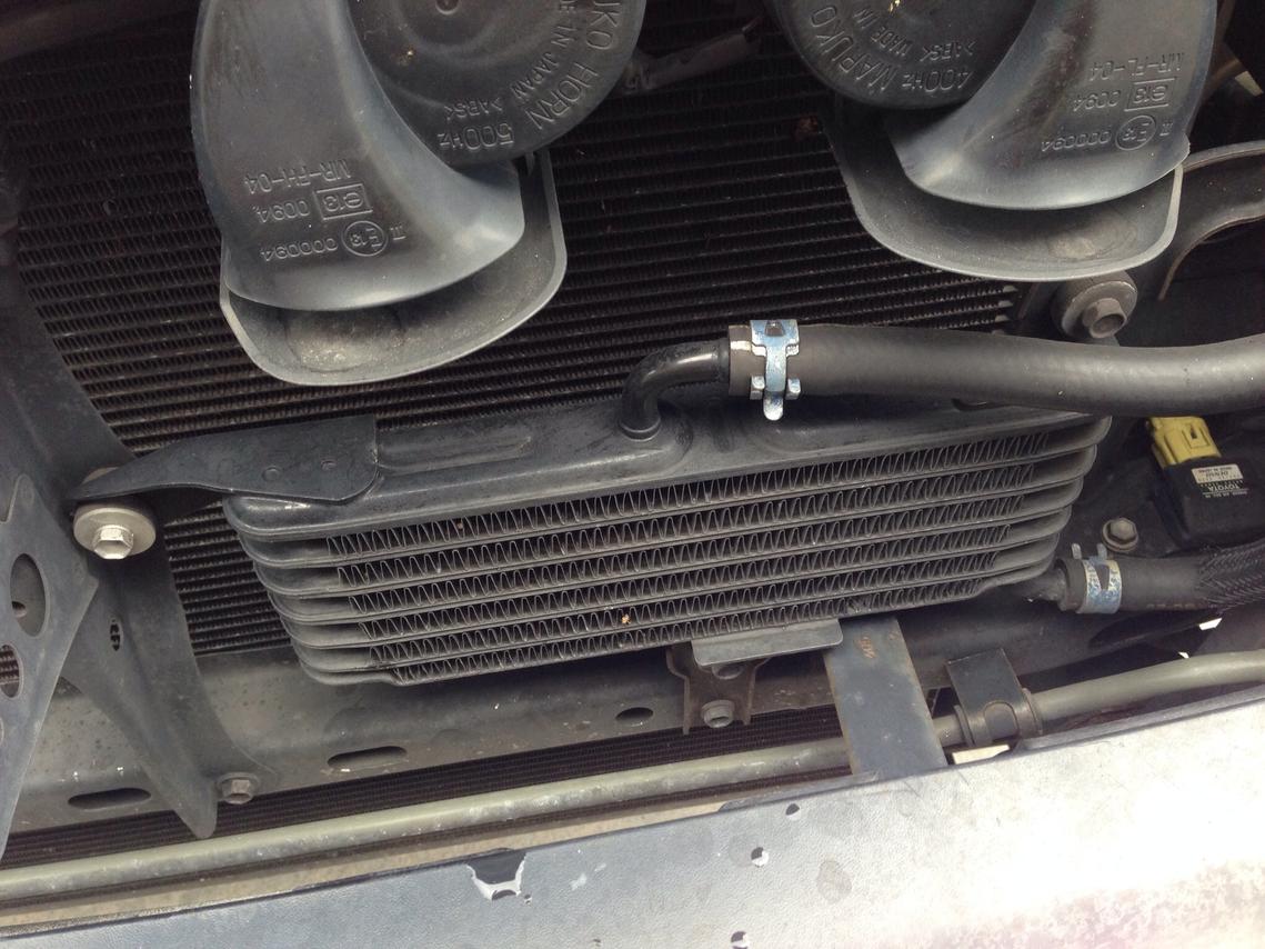

Considering the smaller engine and lack of a dedicated transmission cooler on the new v6 I'd probably get a transmission cooler for that distance. With a rental trailer you will have surge brakes so you won't need a controller. I would also only use a flat bed trailer.
Related to the transmission cooler issue. Has anyone looked into putting a Toyota OEM transmission cooler into the 5th gen that has the mounting brackets on it? I obviously do not have an extra unit but it looks like the current structure has at least one hold to mount it and you could add a bolt for another. The pic below is from my 4th gens.
Have not checked, but other than the VVti in the 4R, how is the engine/gearing different? I'm surprised there is a tranny/axle gearing difference? Makes sense if so, but you are saying the T4R is geared higher/numerically lower than the Taco?
Just checked the Taco double cab gear ratio is 3.73, the tow capacity is 6400 in 2014. HP TQ is 236/266 vs 270/278 for the 2014 4R. Thought the 4Runner has 3.73s too, but not sure.
I have 3.73 in my 2014 4runner which I had to check the sticker/stamp on the rear diff to verify but they are 3.73.
