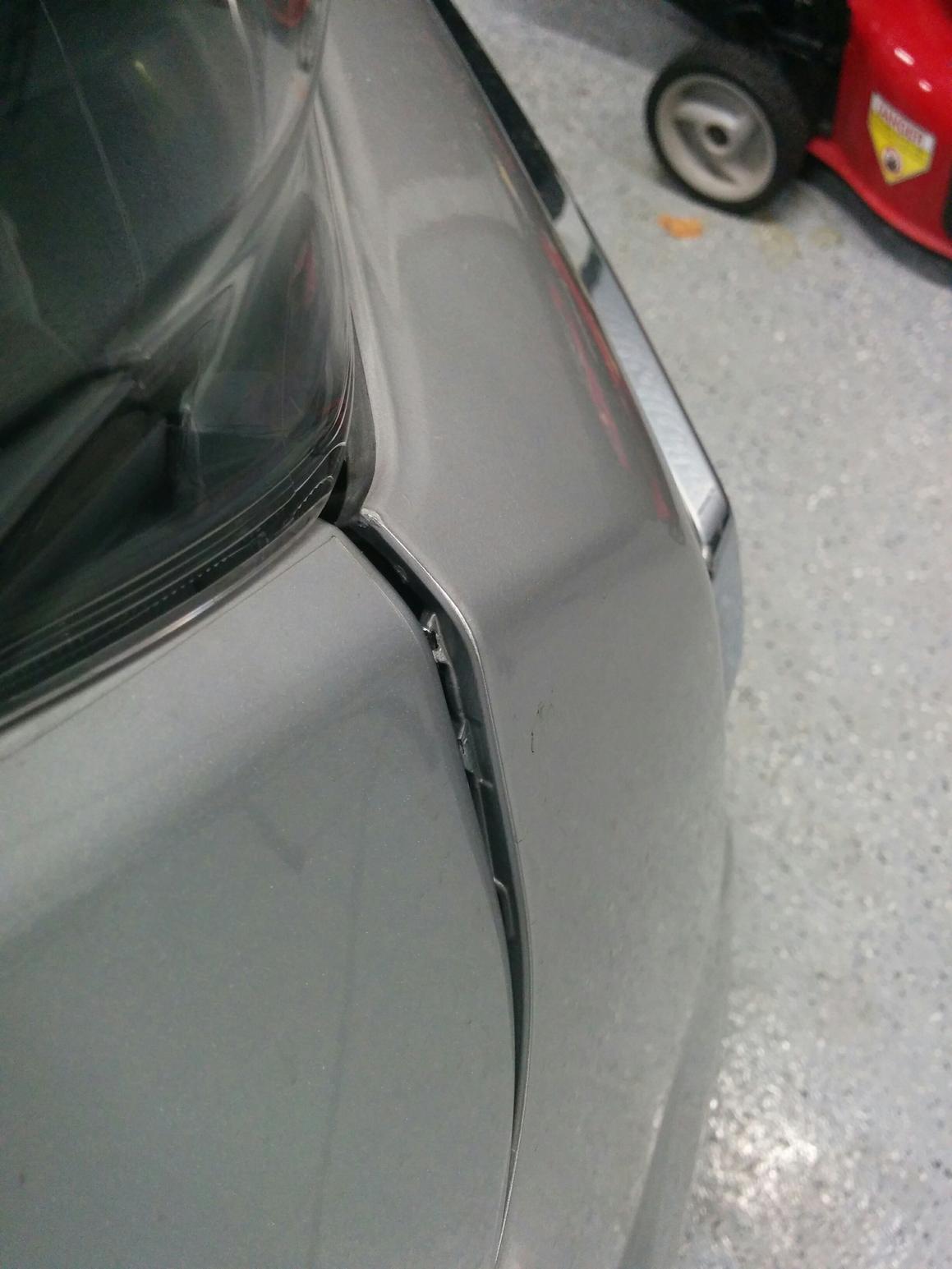

I want to check with the forum if anyone had issue with their 4Runner front bumper coming off on the top edges?
I had it happen on my wife's car and after the Toyota dealership fixed it (according to them they totally replaced bumper) it happened again.
Attached is pic of faulty clip.

Also take a close look that clip is physically broken and im sorry to say but it will not break on its own. Something had to have been hit with that bumper.

Mine is like that. I think a clip got loose after I took off the bumper off a couple of time.
Well I'm gonna ask, have you bumped anything recently?
Also have you tried giving it a soft love tap with your hand and seeing it it pops back in place?
If it is defective and continually popping out, take it back to the dealer and have them check it out; best case they run up a TAS Case on the issue and they replace more parts.

I don't think it has been hit by hand or any other soft object. The only thing that might have done this could probably be car wash.
The side on the picture cannot be pushed back. After dealership fix now the other side is popping out too, but can be pushed back.

i have a 2016 limited that is popping out. Nothing has touched my vehicle except a car wash...it pops back in...very odd that this is happening.
Mine has the same problem. I would pop it back in every time I saw it, but it's been happening so often that I'm just ignoring it now.
i'm starting to think this is mainly on the limited's...it's unfortunate because nothing is broken on the bumper, my 4runner is still brand new, nothing hit it, etc...
but we did find a big run in paint on the clear coat...
The dealer wants to now remove the bumper cover to take another look...
Dealer removed bumper cover, replaced two brackets. was good for about a week. Now both sides are popping out. TAS case is next...very frustrating...any thoughts?
