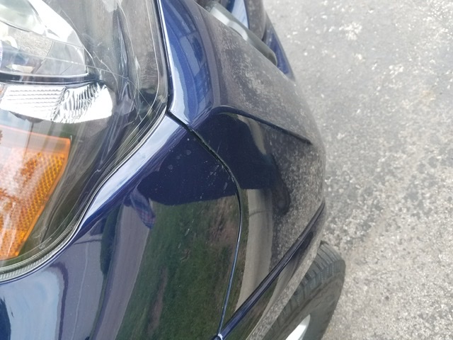

My 2018 did this till I glued it with some epoxy and it’s been holding great for few months now.. this is on a SR5 FYI ... I tried new bumper support that it clips into and it did nothing I finally figured the little tabs on the bumper were just not molded long enough or correctly...
