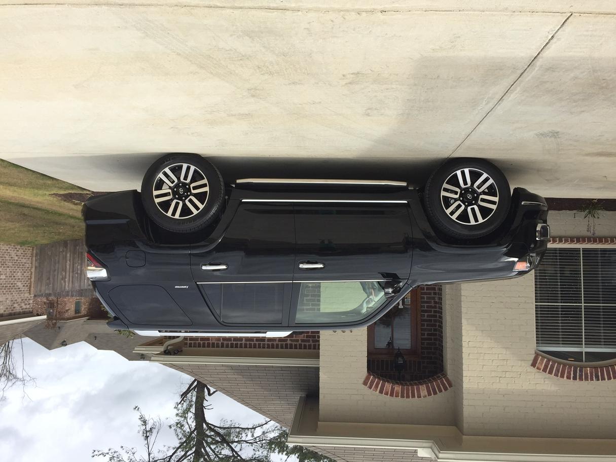

The only thing I am seeing different is the running boards themselves. Our 2016 limited has a different style running board than some in previous searches. No big black plastics part on ends. Looking at this pic of ours I think it will work fine. I plan to get under there and really look at it this weekend.
I dont know why it's upside down?!?
Thanks again

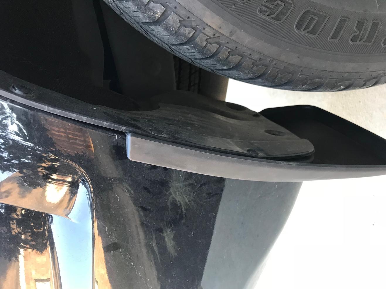

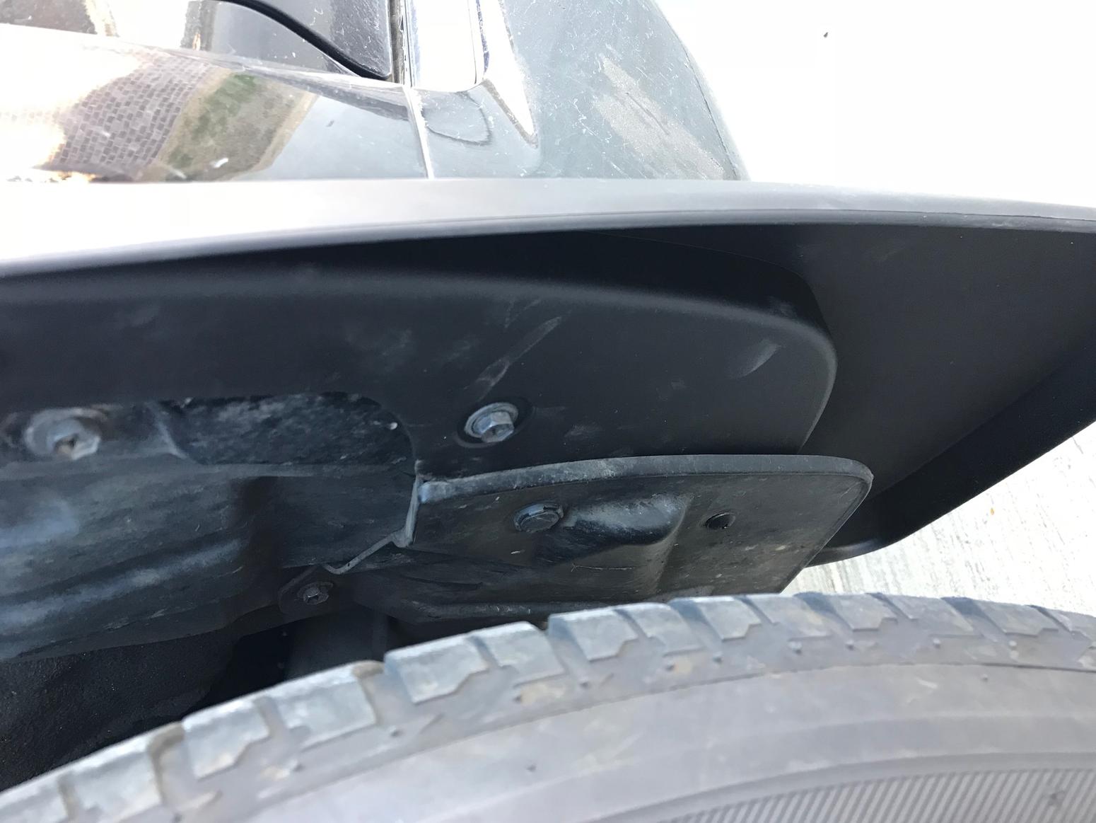

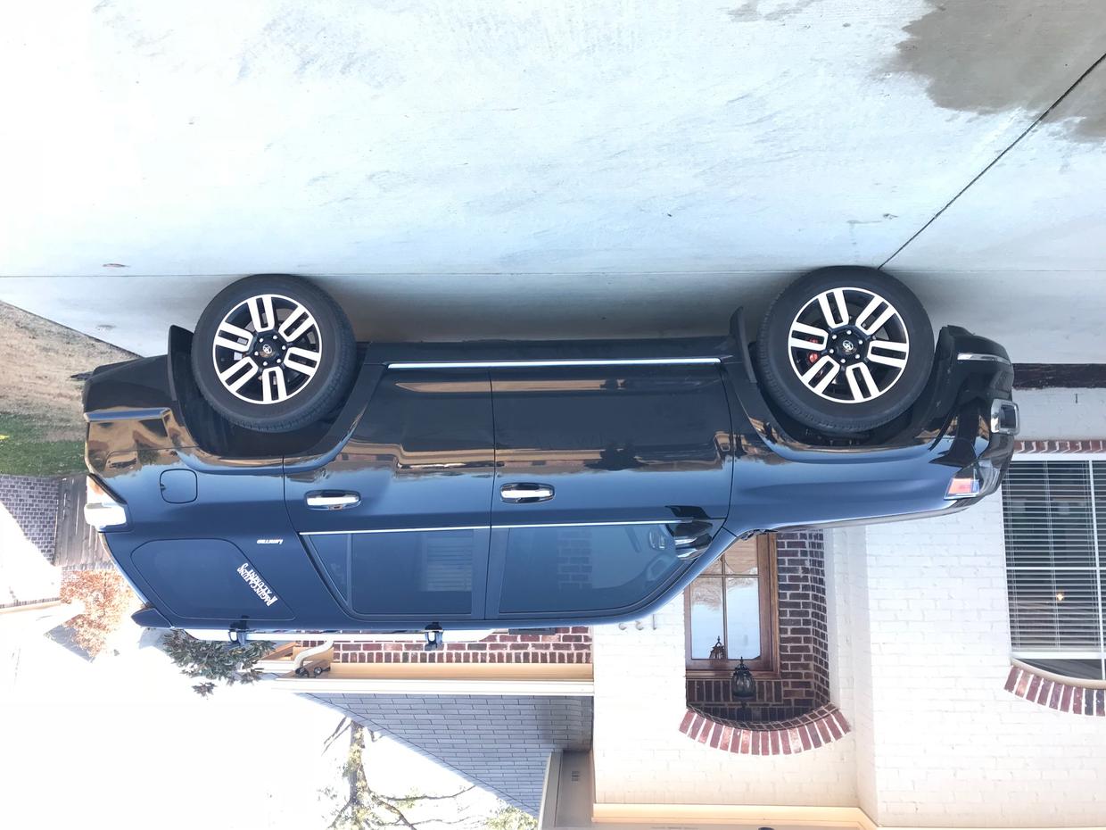

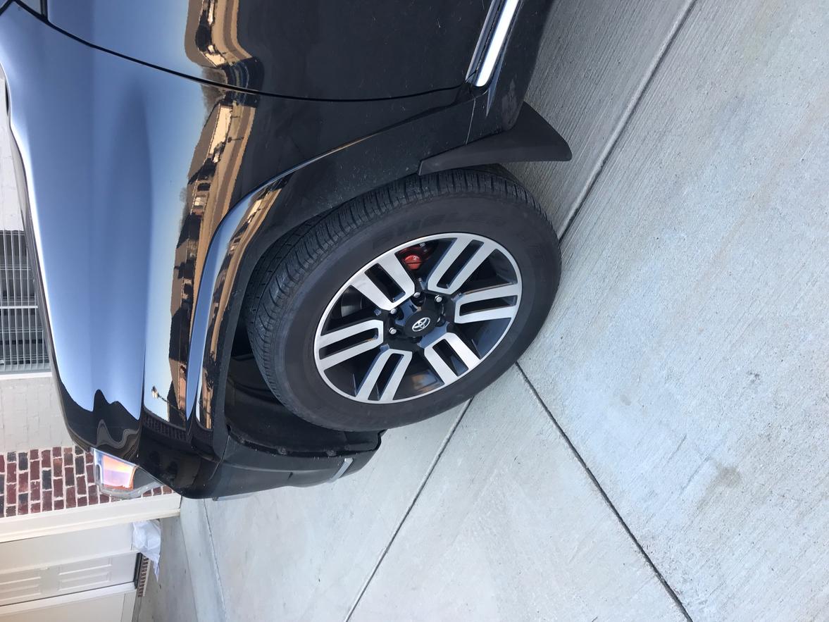

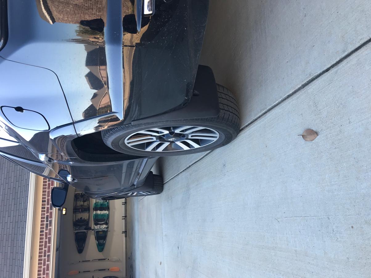

[MENTION=132916]jdsonice[/MENTION] - Yes these mudguards fit on the 2016 limited runner.
Part No. PT769-89110 The pictures below are without the running boards BUT they did IN FACT work with factory running boards.
Easy install, Front Set: I had to drill 2 holes to make them sturdy. There is a smaller version of a mudflap already in place. I took that one off, installed new ones and put that smaller version back on. Worked fine.
Back Set: This one is pretty much plug and play. These fit between the fender lining and the fender. I drilled on hole in each of these again for stability. Not Necessary. (The clip facing down is a PITA to get out and I did not reuse them.) Pics Below
