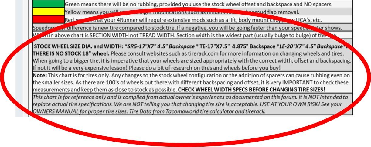

Sorry man. If you would have read my chart http://www.toyota-4runner.org/5th-g...r-5th-gen-tire-fitment-guide.html#post1550444 you would have seen these notes:
check it out and get to work man!
there should be a bit of visual indication of where it's rubbing. But some masking tape on those areas and drive around, cut the wheel, reverse, cut the wheel, etc
if there's anything well-documented on this site, it's how to make adjustments for rubbing.
there's even a proceedure outlined that they use at the port for TRD pro's which involves some bumper trimming at the fore of the front fender.
totally manageable. You're about to be a pro at trimming.
edit: while I was typing this, [MENTION=120065]BlacknTan[/MENTION] posted the exact bulletin I mentioned!
Thanks for that. I think I saw your chart at one point but did not see or read all the notes at the bottom. So I originally bought these wheels for my 2010 SR5. I speced out on discount tires site and called to order. The site said I should do the same but w/ a 9" wheel. The guy on the phone said I should do an 8" to avoid rubbing. I see you indicate the stock TEs have a greater backspace. To be honest, I am a total newb when it comes to wheels, sizing, offsets, etc. It's all gibberish to me.
