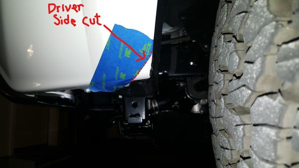

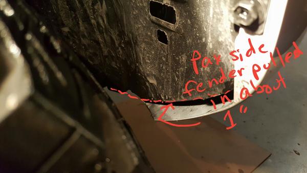

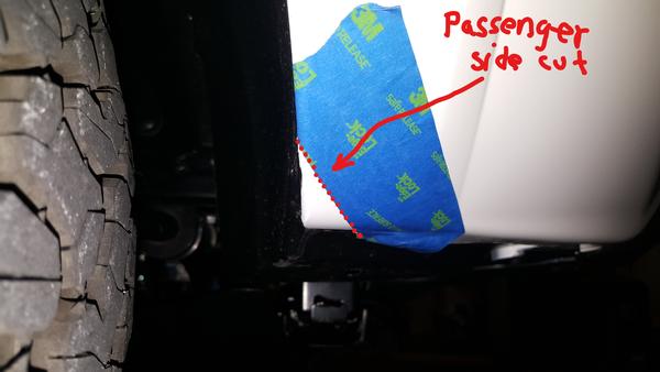

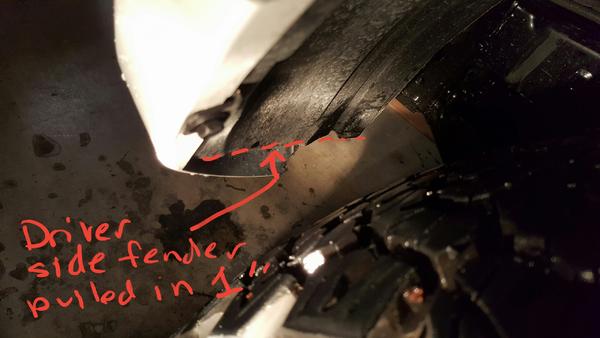

I would be much money that it will be rubbing in the 2 spots the arrows point to. that is where mine rubbed before the lift. The arrow behind the wheel was on the mud flap and I could see that when I turned full lock and got out and looked. There was even evidence on the mudflap. I removed them, no worries. For some reason there is a hump on the mud flap right where the tire lands at full lock. The front arrow is actually rubbing on the bumper, but was only when in reverse and turning sharply. You can see where it rubbed paint off in the 2nd pic. When I removed the mudflap, I would say 90% of the rubbing went away. I was careful not to turn too tight when backing up and I rarely ever rubbed.

I am not sure what damage it would cause. I am sure the mudflap would eventually have a hole in it. To me it was more an annoyance and I was worried more about hurting the tires. Had I not added the lift I would have trimmed that little piece of bumper with a dremel or knife as it wouldn't be noticeable.

Haha! Well I am came in here to update the post after working on it tonight and you are correct, sir!
The MAJORITY of the rubbing was the hump on the mudflap. The rest is the on the little section of bumper cover that sticks out past the wheel well liners. I moved those forward too just in case but I really need to trim the bumper a little. It was cold and I was tired so I did a quick test drive and called it quits for the night.
The major loud rubbing sound (sort of popping) is gone. The snow was frozen and really loud/squeaky to drive on, so I need to wait until I am on a quiet dry parking lot again to see where I am still hearing any rubbing.
I just hacked the bump out of the mudflap since I like the look of them being on. I sort of wish I would have just heat gunned it and pushed it out.

What I want to trim
http://i.imgur.com/0nY0d1Z.jpg

You're right, on those they ground down both sides. I got some at lowes today but didn't end up using them or cutting the bumper yet. All the ones they had, had sort of a beveled edge down to the blade. Not sure how an unmodified one would work to cut the bumper. When I do that, I think I may use a power tool, hand hacksaw, or just use a razor. See my last post in this thread though, I think I fixed most of the rubbing.

1.) How did you pull them back?
2.) Any more rubbing?
1. I pulled them back from the method that [MENTION=50362]jayhat[/MENTION] posted a page back...starting from the 5th picture.
2. Actually, I am getting very very little rub, but its only when wheels are turned at full lock AND breaking at the same time. I attribute that to the nose dive. I'll have that resolved soon with the Bilstein 6112's I'm about to have installed though.
