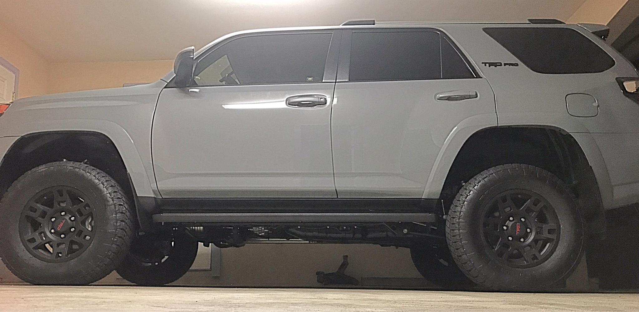

I got my icon lift installed, but having trouble installing back my skid plate after putting in the diff drop. The angle of the CV is not so much of a difference from the stock but I'd like to raise it some more to level the front with the rear. Could cause me a potential problem?
I don't know. Anyone please?
I got my icon lift installed, but having trouble installing back my skid plate after putting in the diff drop. The angle of the CV is not so much of a difference from the stock but I'd like to raise it some more to level the front with the rear. Could cause me a potential problem? I don't know. Anyone please?
A differential drop on a 4Runner will not do anything to level out your CV angle, as it doesn't actually drop the differential.
Did you notice the "diff drop" did not really change your CV angles at all?
Remove it and move on....
Your diff drop is not doing jack! Get your 3 inch lift and aftermarket UCA's and roll on!
