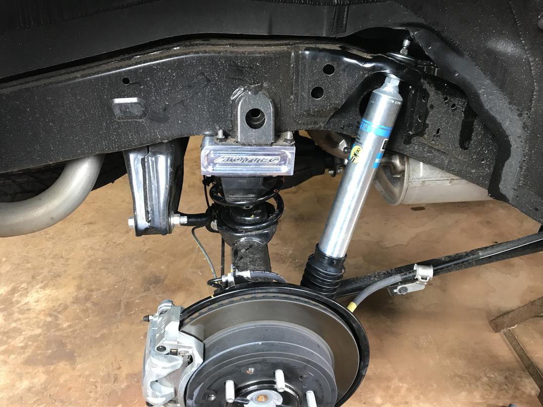

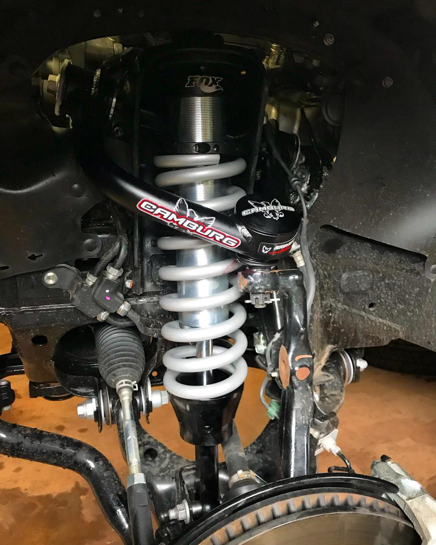

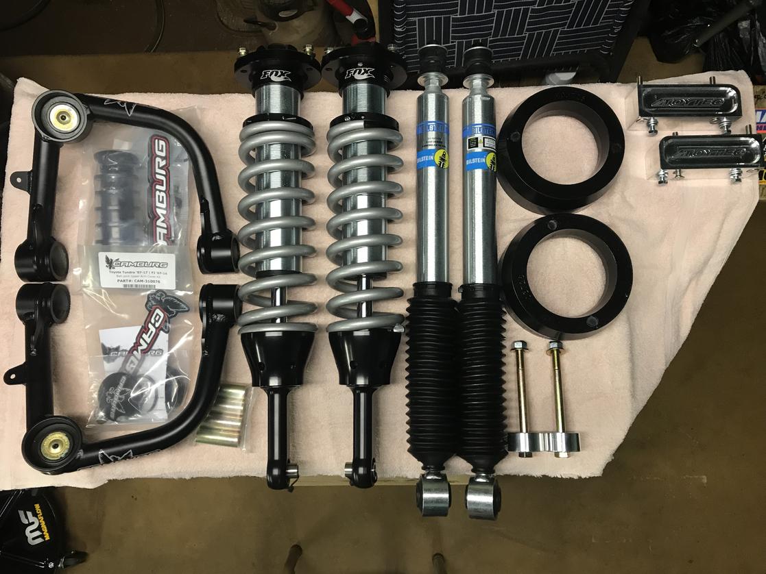

2018 TRD Off Road Premium with KDSS. Fox 2.5 coilovers set at 3". Camburg Performance Ball Joint UCAs. Toytec 1.5" rear poly spacers. Toytec 2" bumpstop relocation spacers. Bilstein 5100s. 285/70R17 BFG KO2s on 17x9 Fuel Sledge wheels. My tips on lifting KDSS equipped 4Runners. The front swaybar did not need to be disconnected at all to install the Fox coilovers. For the passenger side (solid mount) I jacked up the driver's side LCA and that gave me enough droop to pry on the passenger side LCA enough to get the coilover in. The driver's side goes in no problem. For the rear I disconnected both sides at the axle. Check out the vids. I also have vids of installing the TRD Pro grille and tube steps on my Youtube page.

I'm planning to put the Bilstein 5100's all around for my 2017 KDSS TRD Off-road, do you think I don't need to detach the KDSS swaybars either?
The driver's side goes in no problem because it has the hydraulic arm that moves. Try jacking up to driver's side to give the passenger side more droop to get the strut in. The Fox's went in without touching the front KDSS.
Out of curiosity, why did you spend so much on your front coilovers and then buy inexpensive rear shocks?
