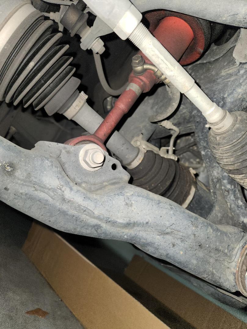

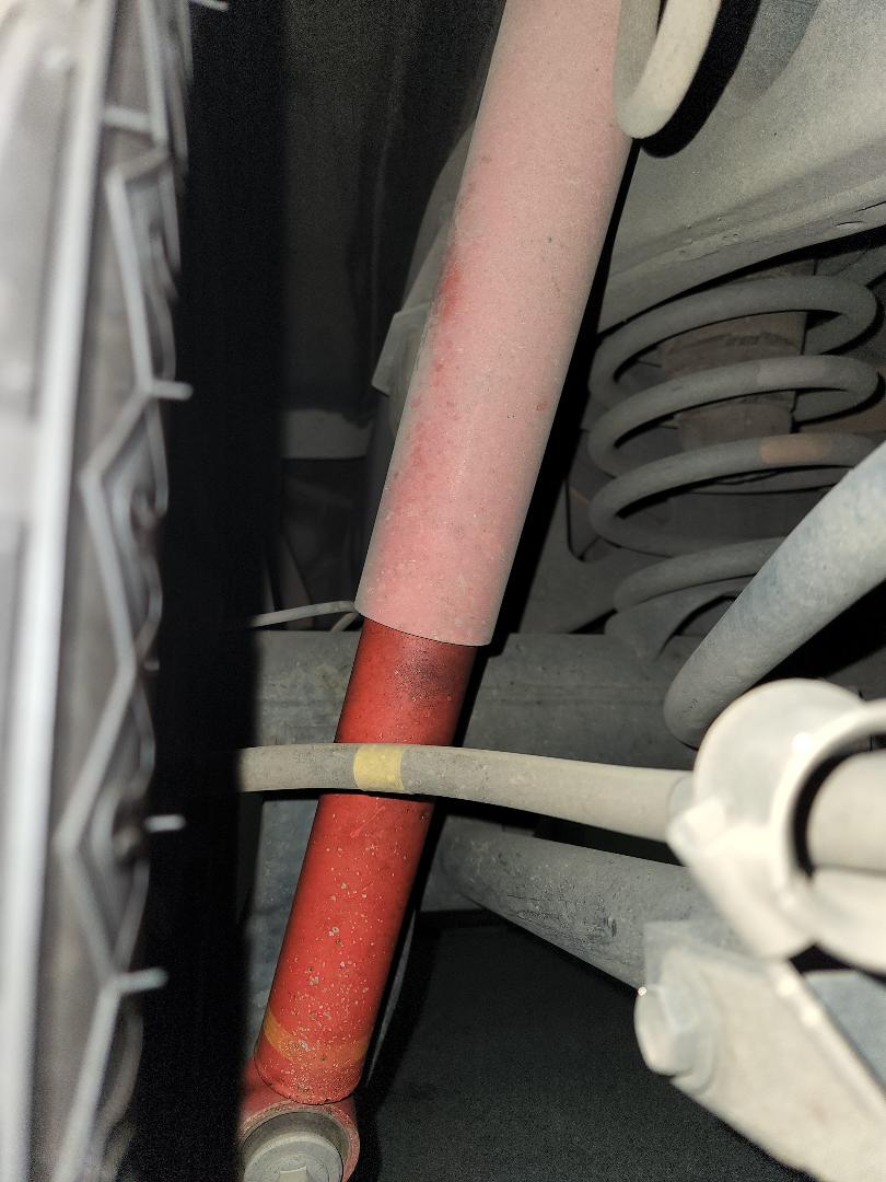

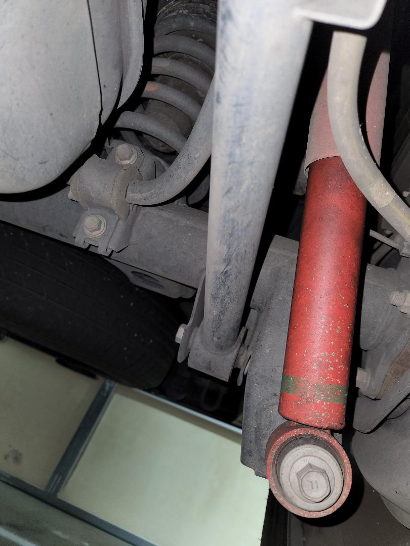

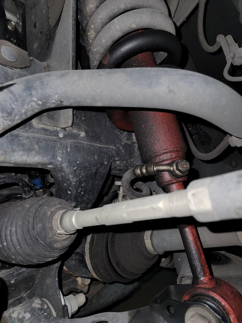

I just was under my vehicle, and noticed the drivers side shock was pretty wet. The others look okay. Looks like the banjo nut leaked, which would be fluid.
Thoughts?
Is there any test to see if they are "bad" or low on fluid?

the front two look bad. the rear two look OK. under warranty still? there is no test to see if they are low on fluid but you may experience a poorer ride quality
probably not enough fluid has been lost to warrant replacement of the hard lines as well (you can't top up fluid with XREAS - closed system). since the vehicle is new you can probably get away with replacing just the fronts (shocks come slightly over pressurized from the factory so a small amount of fluid loss isn't a big deal). a set of two shocks is probably $1200 to $1400 with labour. XREAS replacements are expensive that's why so many people hate them. I replaced 4 corners on mine after about 155k miles (no hardlines) and it cost about $2600 after tax

Looks like normal road grime. If your XREAS shocks were leaking they would be really wet and shock fluid would be dripping from them.
