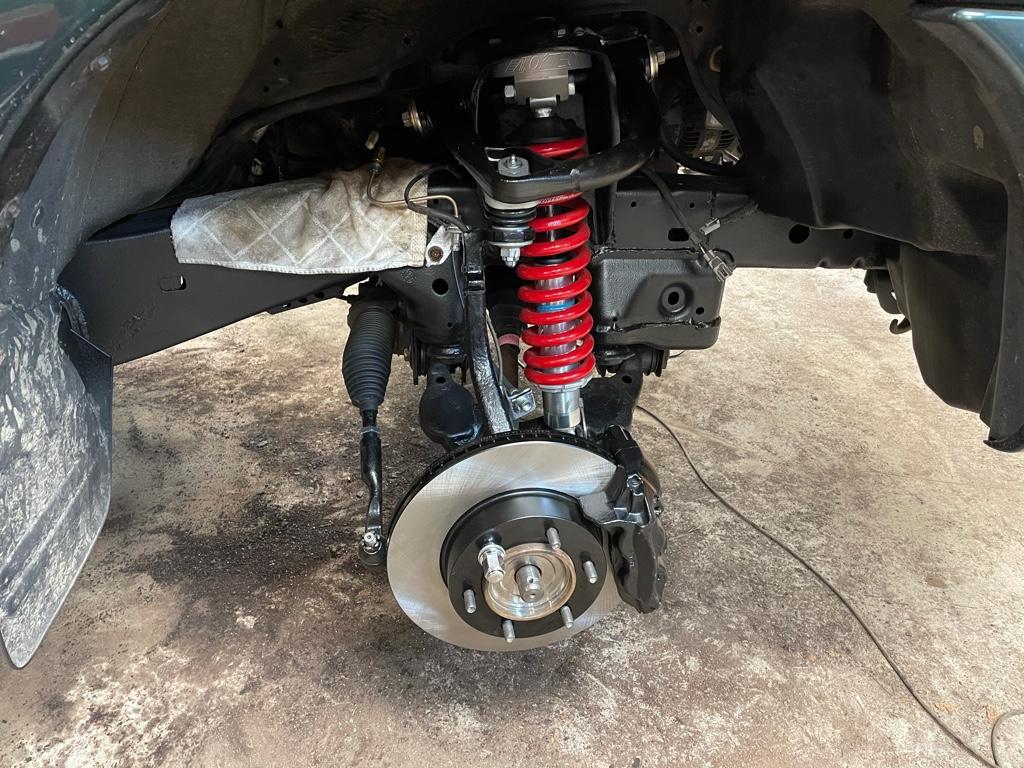

I have the Mevotech adjustables on the way, which at least in the past were SPC. AutoKart has them for 200/piece. Will report back on what I receive when they arrive.
Due to the difficulties in getting someone to do a decent alignment around here, I'm probably going to follow a DIY alignment guide on the Tacoma forum... that will at least get me in the ball park.
I went with SPC’s on my 02 Sequoia build. Well made, and super adjustable UBJ.
I'm running Camburg UCAs (ball joint) on my 4R. I kind of wish I had gone with the uniball joints but they are a couple hundred more dollars and I was on a budget at the time. I've read that the uniball joints have a longer life span but I have yet to see any tangible evidence to prove it. But if my UBJs fail, I believe I can replace them without replacing the entire arm. I've got Tuff Country uniballs on my truck and they do their job and have been for over a year now.
I went JBA and am happy with them. High caster for the lift and alignment was a breeze. Super easy to get back in spec, didn't need all the adjustment from SPC. Wanted something with a ball joint instead of uniball due to climate in MN... and I like the fact they are replaceable (again like SPC) Pretty sure anything aftermarket will do what it's supposed to do if you buy from a reputable brand. I went JBA due to cost and availability...
