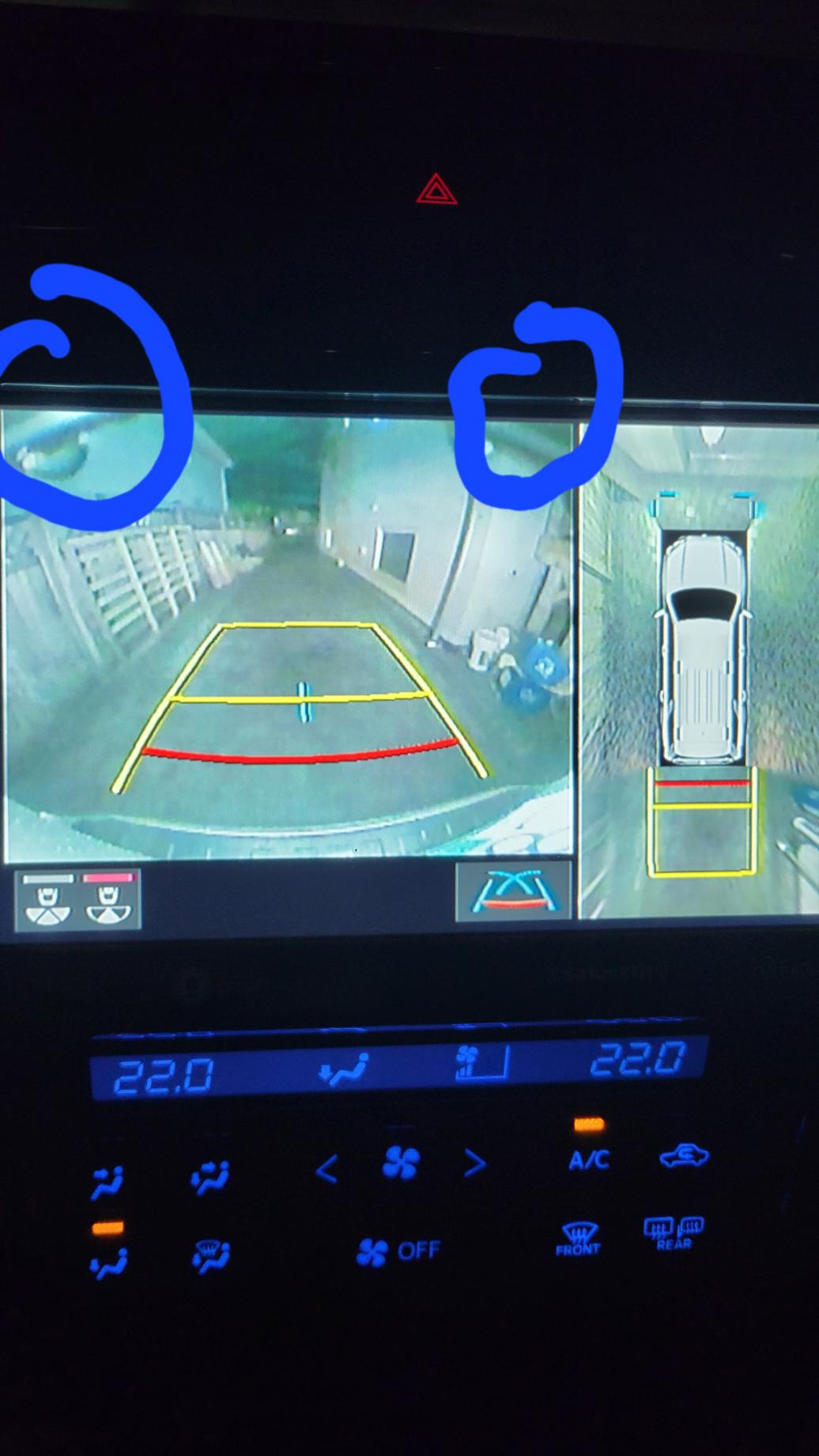

Do any of you have the concave outline blocking the top corners of the lens? I never had this before and saw a full picture without the rounded blacked out corners.

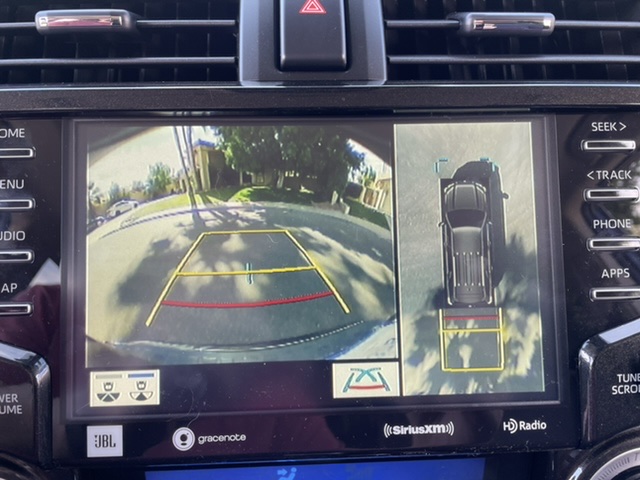

Here is a view from my 21.
I feel like your 2021 looks a bit better than my 2022.

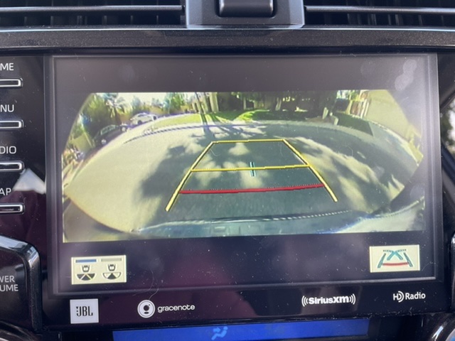

Also I just realized that when I put the view in full screen, the top of the screen is cropped with a black bar and we don’t see as high as when I have the split screen view (in both pictures, I have not moved the trucks, just pressed on the button to change the view)
So, different camera from mine. I don’t have the function you have, also, camera is tucked under your trim.
