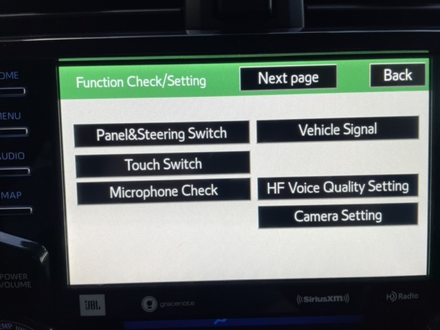

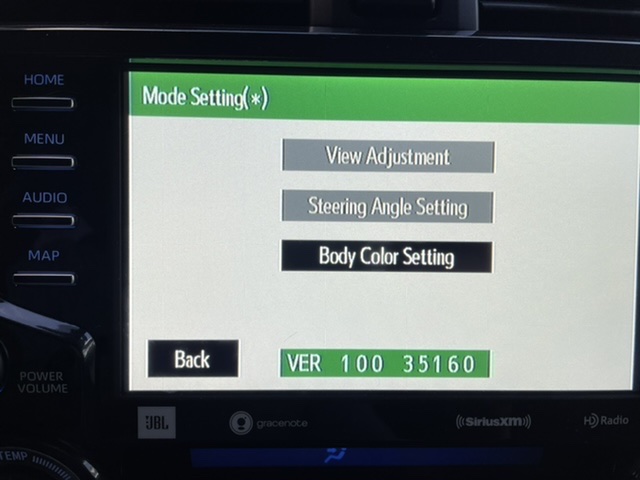

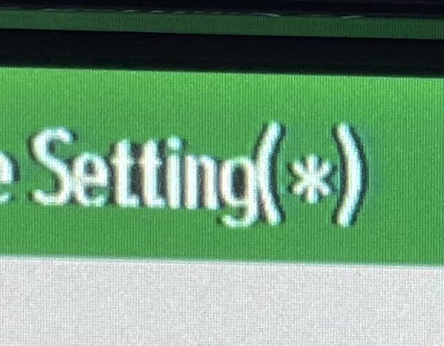

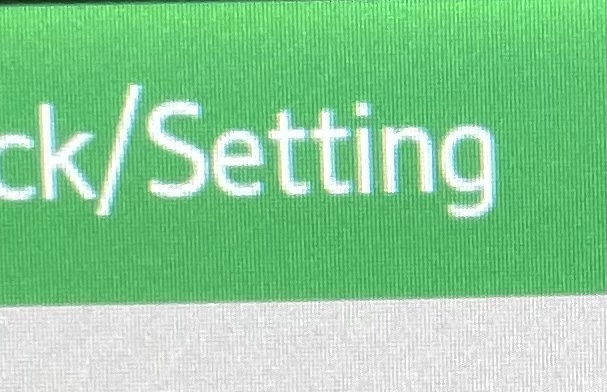

When going in the “secret menu” the resolution of the screen looks decent, but when entering the camera menu, it gets a lot worse.
Notice the difference of quality in the word “setting” from one menu to the other:
Notice the difference of quality in the world “setting” from one menu to the other:
Nice comparison.
My working theory is in order to keep shipping 4runners with the same feature sets amidst the chip shortage, they've reverted to using older camera modules... the screen isn't the issue, it's that the output of the camera module is decreased.

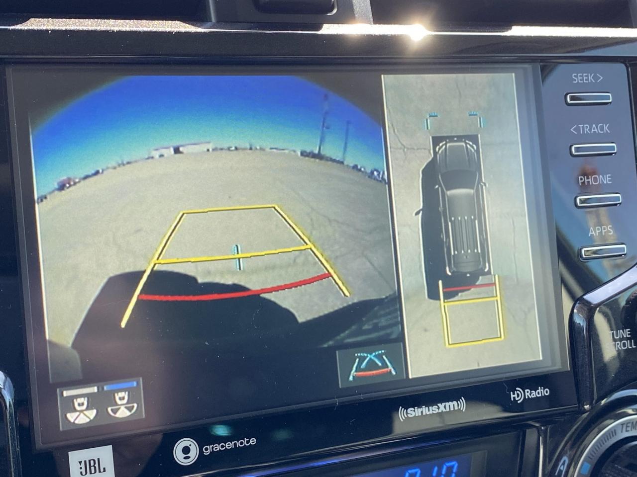

We have had our new 2022 ORP for a couple weeks now. I've never owned a car with a backup camera before and been a while since we rented one, but have to say the image quality on our new 4Runner is better than I was expecting, after reading this thread.
Could it be the pixel density of the bigger screen? Same resolution camera but now stretched on the new Entune 3.0 system?
It's not as bad as everyone is complaining about... I had a 20 and now a 22 with the 360 camera. The camera resolution looks exactly the same to me. I guess people are expecting a 4K HDR10+ resolution for their backup camera or something. I have a Sony at home for the 4K stuff. All I need my camera/cameras to do is let me see if there's any obstacles in my path or not. I don't need to see every grain of sand and blade of grass as I'm going in reverse. :shrug:

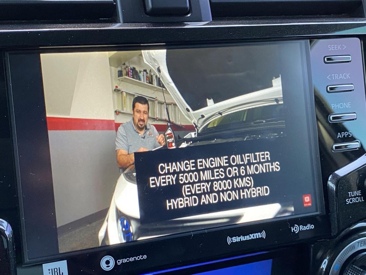

I guess this thread is kinda worthless without some pics.
Backup camera vs YouTube video
Thanks for the video. The camera quality is really garbage. Regardless of whether I am in ‘top’ view or wide screen. Our cx5 is better. I swear the ‘21 sr5 I rented was clearly better. Anyone verify of the part numbers for ‘22 are the same? I bet we will be digging into swaps before long.
