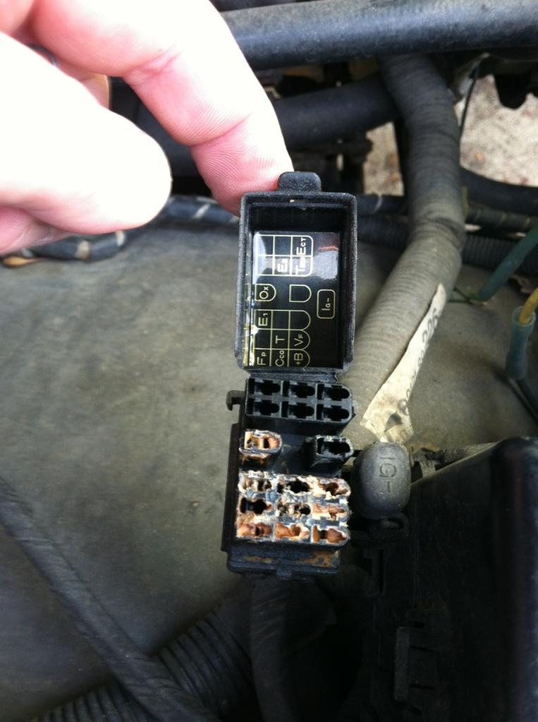

I found the instructions it says to jump TE1 and E1 I dont have a TE1 in my box.
1c63658f.jpg~original
2 quick flashes then about a 2 sec pause then 1 flash so I am reading this as 21 which would be the O2 sensor. Would the O2 not being there cause it to skip?
