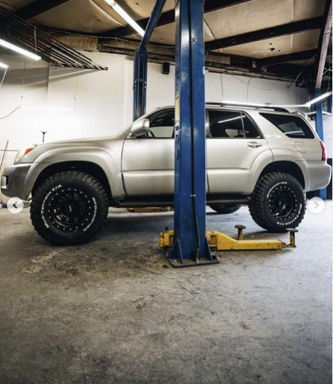

Was given a set of 34's....after the trimming and tinkering I love it.
