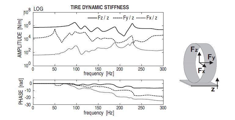

All the applications I’ve seen were LT tires and the subsequent conversations were that the taller tire needs a bit of help when it comes to bending modes… the way the tires bend inward and outward from the center-line of the rim when turning under loads in which there is a significant transfer of energy… centrifugal force is outward but centripetal force (note the difference) is inward and the outside tire bends inward when transferring load in a turn. Our vehicles are rather heavy and these load transfers can be significant. I went with slightly higher tires at 192.5 millimeters but went with LT C load. You’ll be close at 191.5 millimeters but you did not mention whether you’re evaluation P or LT tires. Based on weights I would expect P series. I did not like my ride with P series at 185.5 mm… would probably like it less at a higher height.
