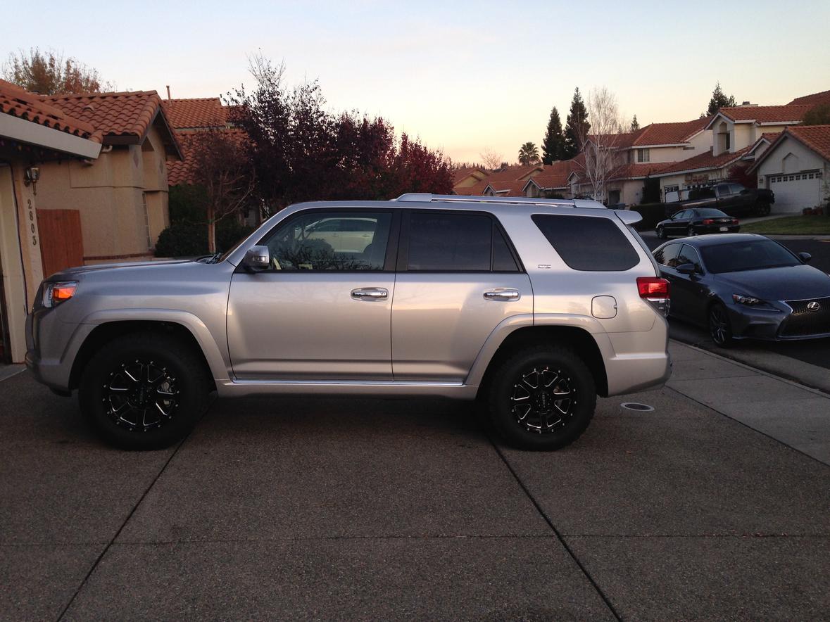

I had mine on post lift 18x9 0 offset

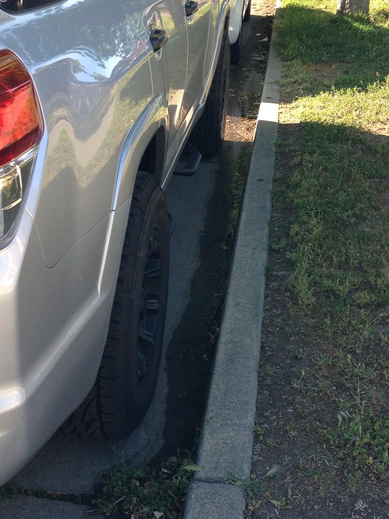

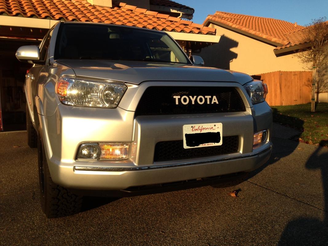

Now that it is lifted I do not have much, found this one so hope this helps.
No rubbing except on the drivers side in full lock revers ever so often on the front liner. Nothing noticeable or to worry a out.

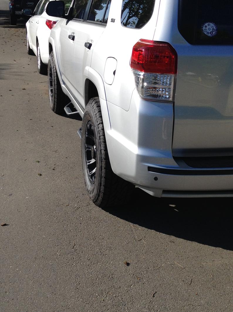

17x9 -12 black rhino sidewinders
Revo AT2 285 70 17
After alignment minimal rub, no lift yet, no worries
