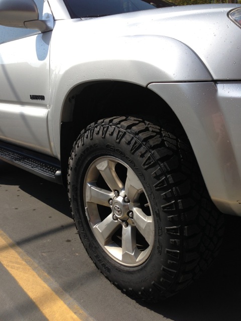

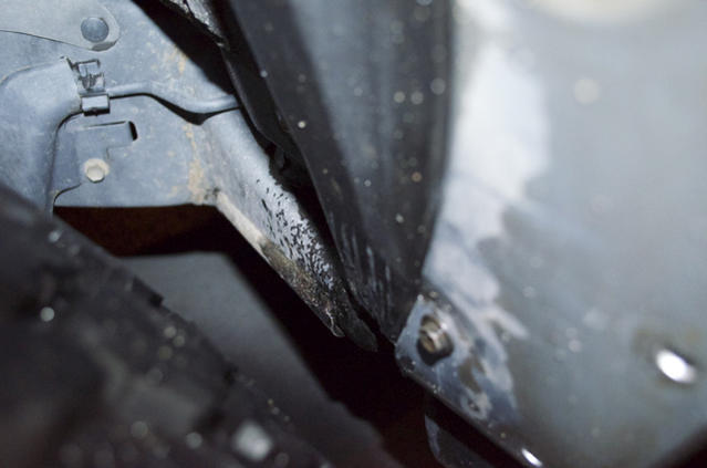

So I bought some Duratracs today and have rubbing in the expected places although the drivers side rubs more than the passenger side. More than what I was told it would.
The passenger side barely rubs but the drivers side touches the body mount. I was told I'd have no rubbing if I removed the mudflaps, which is almost true.
is it normal that the tires would rub more on the drivers side vs the passenger? is there something that could be done to help this besides a body mount chop? am I out of alignment or something?

Start with an alignment! If u spent over or close to 1k on tires def get an alignment! Caster could be off!

That's the exact setup I'm running, although I have 1" more lift. I still have my mud flaps on (trimmed) and no rubbing at all. You shouldn't be hitting the body mount with those 275's. As mentioned, get an alignment and have them max out the caster (as much as they can keeping other numbers in spec).
yeah it's rubbing pretty bad, its the body mount on both sides, more on the drivers though. I hope they can fix it during the alignment. I might do a body mount chop if not, a 1/2" body lift might also help.
It only seems to rub when backing out of parking spots, so reversing and turning. going forward it doesn't rub enough for me to hear it at least.
So max out caster, I'll mention that.

driver side sags more than passenger side 90% of the time.

initially I trimmed my mud flaps in the spots it was rubbing but it didn't work out so now I have no mud flaps and its a lot better but I think it still just barely nudges the body mounts when reversing and turning or if I hit a bump while turning at full lock.
it's not so bad now but I have an alignment tomorrow so that might help with that slight rub I have left.
tires feel great though.
I still rub on something, i have no idea what when i back up. On the driver side but i've trimmed all the plastic i can. Ill have to get in there and really take a look. I only have 265/70s for crying out loud.
Got an alignment yesterday, caster was already maxed out.
Still rubbing rear of wheel well and body mount when reversing while turning also when hitting a bump while turning at full lock.

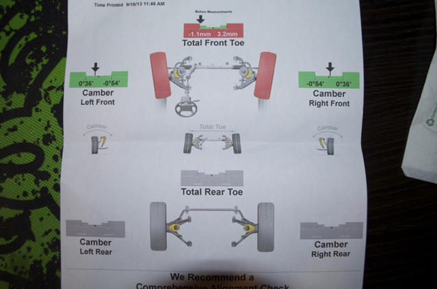

Can you post your alignment specs? I ask as the last alignment the shop did increased my rubbing substantially. I had no rub, after alignment I have to remove my mud flaps. I am not sure what was adjusted, but my wheels were brought back in the wells (caster??).
Sure, I'll post it tonight.
A local member here has the same setup as you (08 Limited, XREAS, Daystar 2.5/1.5, Spidertrax) with 275/65/18 BFG AT's (which are known to be one of the hardest tires to fit due to their square profile) and he doesn't rub the body mount. He still has the mud flaps on too, just trimmed them.
If all else fails and you don't want to do the BMC, consider a different set of wheel spacers. You can get spacers from Motorsport Tech in either 3/4" or 1", depending on the amount of contact you have these could take care of it.

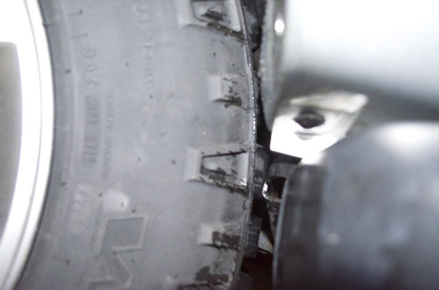

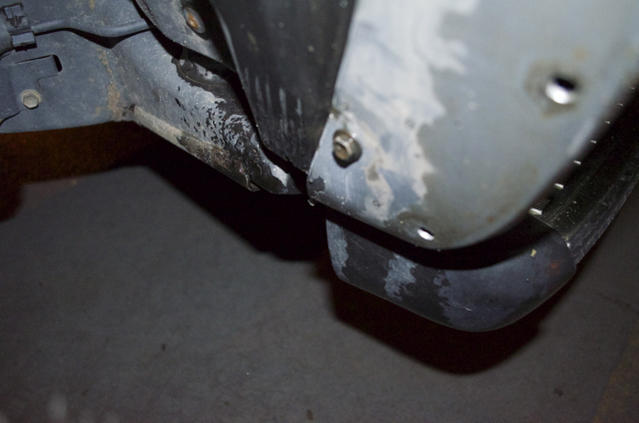

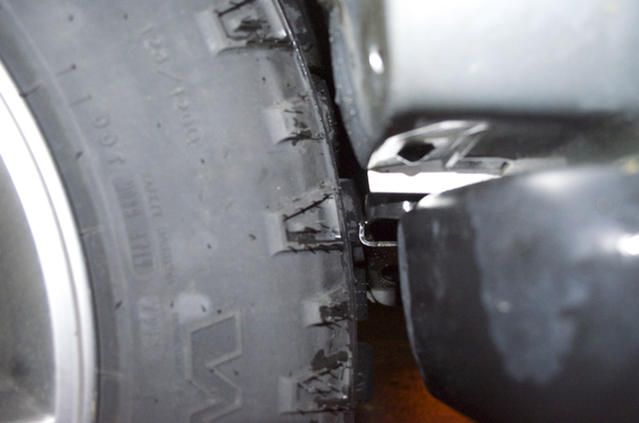

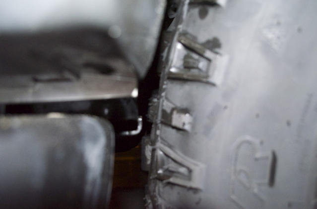

Pics.
See the rub marks on the black fender liner as well as on the body mount. Also in two of the pics you can see the tire actually touching the mount while turned full lock on a flat surface.
the last pic is the passenger side.
and then the alignment sheet.

Strange, my set up was no where near that close to the body mount or fender. I'd just get light scuffing while going up inclines and turning. Not sure what to tell you...you could try trimming that plastic fender...but if it's hitting the body mount, you'd have to get that chopped
These are the issues I'd image having if you were running 275/70/18...not 275/65/18
