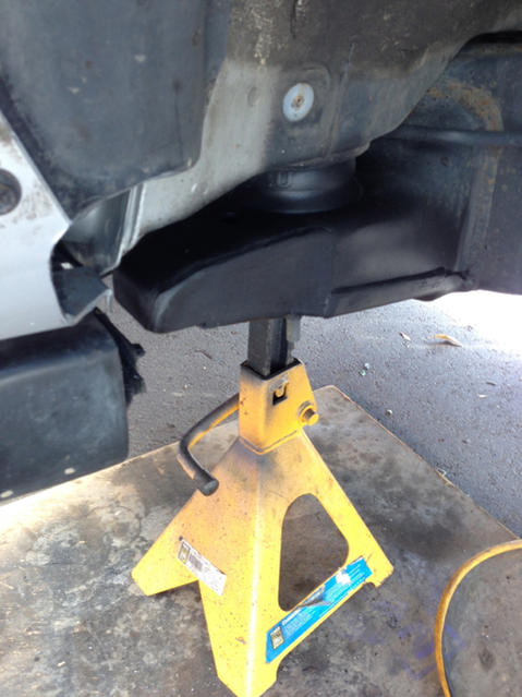

initially I trimmed my mud flaps in the spots it was rubbing but it didn't work out so now I have no mud flaps and its a lot better but I think it still just barely nudges the body mounts when reversing and turning or if I hit a bump while turning at full lock.
it's not so bad now but I have an alignment tomorrow so that might help with that slight rub I have left.
tires feel great though.
SO I see here you say it rubs at full lock while turning and reverse...yes, I got slight rubbing while doing that too.
problem solved.

The tires don't have enough clearance from the UCA, have to have spacers on. It still rubs when I hit bumps while turning, wish the smaller duratracs were available when I bought these but oh well, one day i'll have a proper 3" lift and that'll fix it.
did you just cut the plastic by the body mount ?
I noticed mine is rubbing there as well.
Yeah, just use a utility knife, or razor blade of some sort. keep trimming little by little until it stops rubbing.
for me, there is a body seam on the rear side of the wheel well that I still rub on, not much I can do about that since its behind the wheel well liner and I'm not about to remove that just for a little rub.

Still trying to figure out what this "Body Mount Chop" does and looks like. Is this something simple or would I just them "chop" it off lol when I get my suspension installed?
