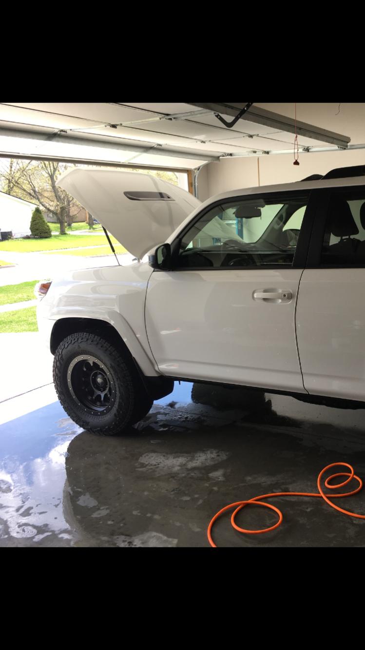

2.5 Front, 1.5 rear... 275/70/17 E rated K02s. Method MR312 17x8.5, 0 offset.
Love the ride and handles very well... Still considering going 285/70/17 with C rated K02s or the new Wildpeaks.
NICE looking rig. Mind me asking which lift kit you used? Specs?
I have a TRD Pro, which, has the fender liner mod and is 1” higher up front than the other 4Runners from the factory. I added Burtman Industries Cornfed 1.5” split spacers to the front and 1” spacers to the rear. I like the setup. No removal of the mud flaps, no rubbing at full articulation or frame cutting required. 275 BFG KO2’s.

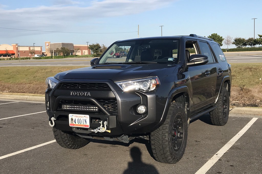

275/70/17 BFG KO2s.

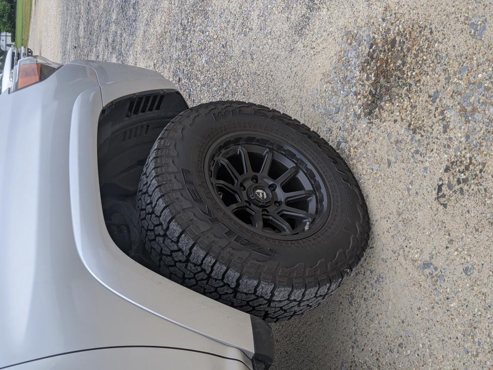

Here is my 20 pro on scs wheels and fallen 275's slight rub on the flaps at full lock

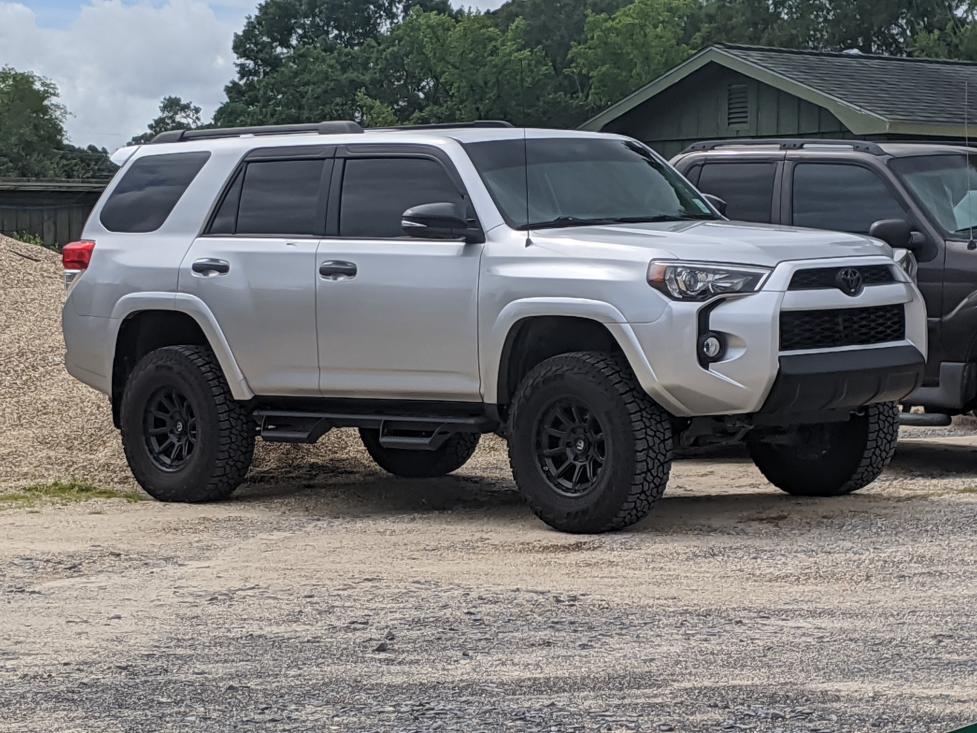

275s on Fuel 17x9s..
0 offset
C load
Ran 285s on last 3 Tacoma's I owned, and decided to drop down. Should have done this years ago. Best decision I've ever made. I average 17.2mpg in town, and at 68-70 on the interstate will hit 20.5 easy.
Bilstein lift. 2.5 in front, 2 in rear.
