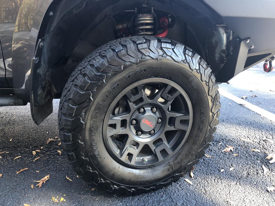

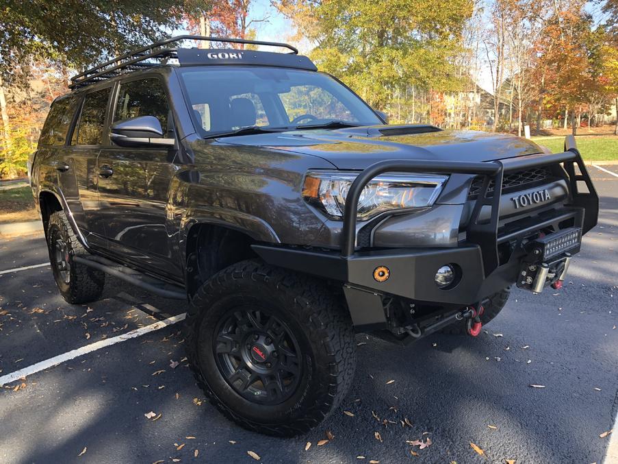

I have them...see pics. Before I put on the CBI front bumper I had to pull the wheel well liner forward a bit.

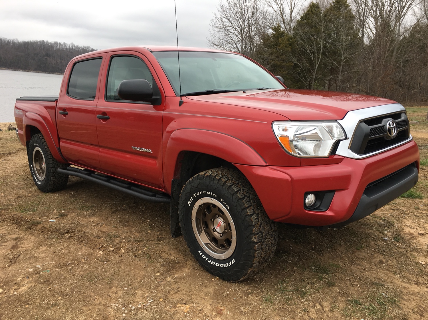

You need to check with the stealership! I put the bronze TRD wheels on my Taco a few years ago and needed to purchase a new set of factory lugs & locks!
These are the wheels!
