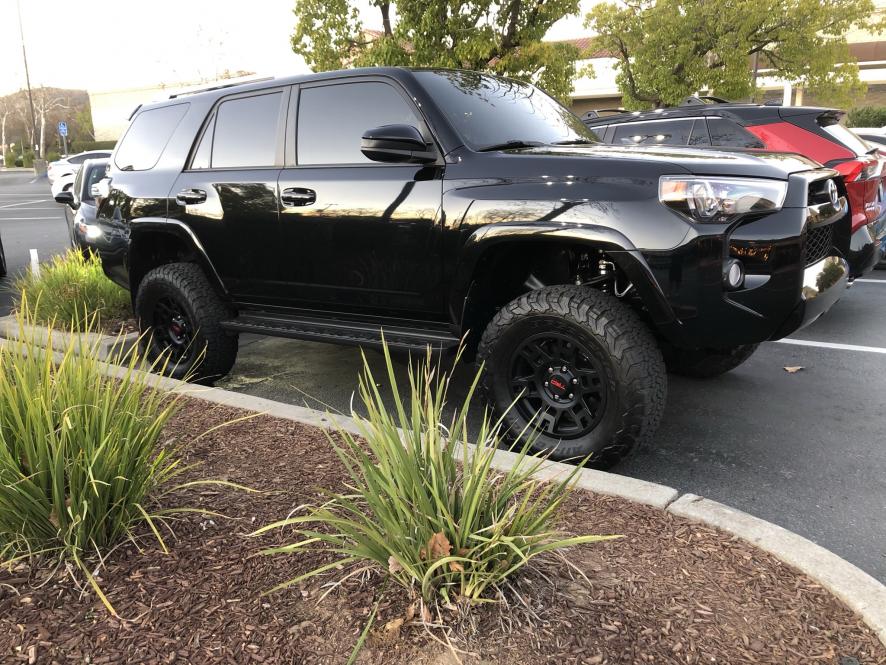

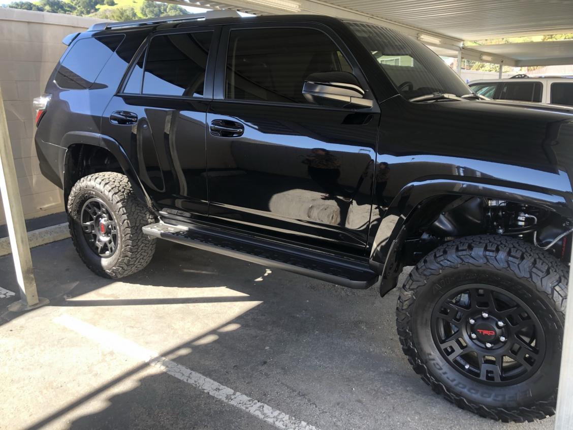

No BMC NEEDED
Hey guys just head to give that notion of the whole a BMC is needed when running 285/70/17 on stock trd pro wheels.
3” lift
SPC UCA
285/70/17 BFG KO2
