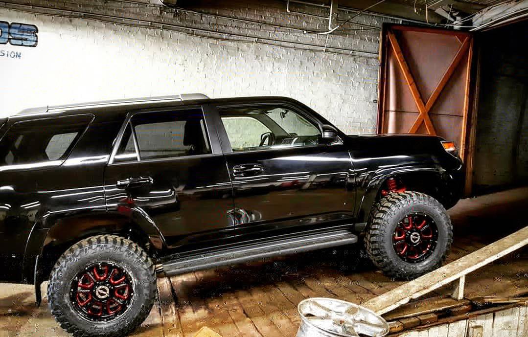

Nice looking rig! I'm picking up my 2018 TRD Off Road Premium tomorrow. I bought a set of black TRD rims, and I was wondering what type of black lug nuts you are using? Do they fit the TRD rim like the factory lugs? Where can I get a set? Matching wheel locks?
Thanks
They’re just black painted lugs off eBay. I don’t use the locks. With a lift very few people would be capable of jacking up your rig to get the wheels off!

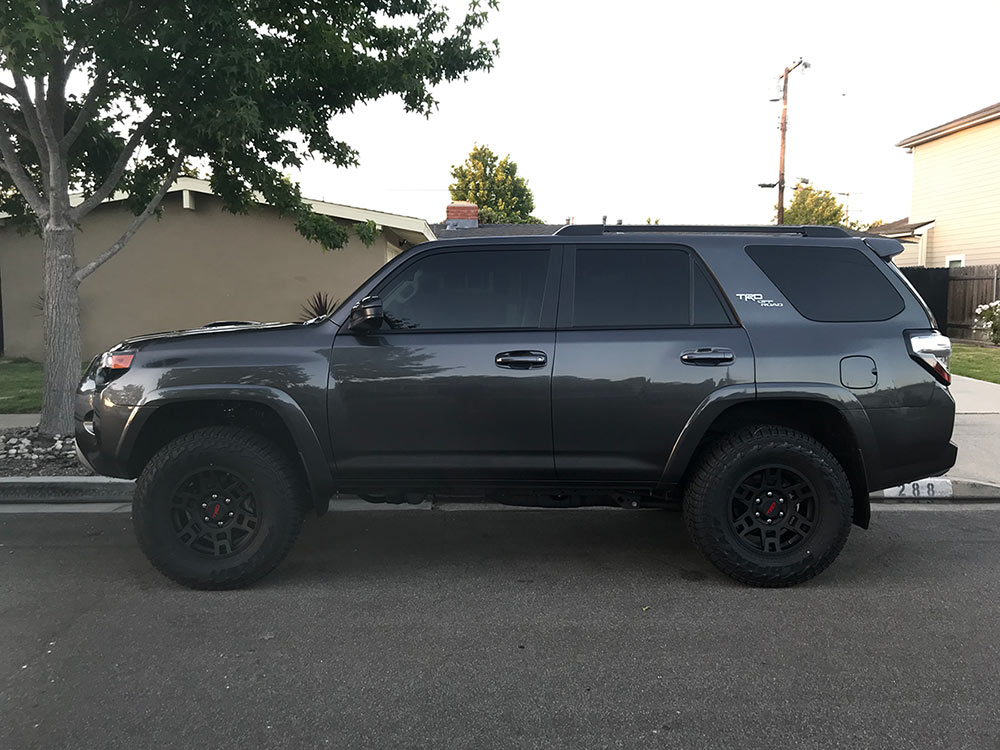

A little late to this party, but 285/70/17 Mickey Thompson Deegan 38's on FN FX Pro's (17X8). 3" Toytech, no rubbing.

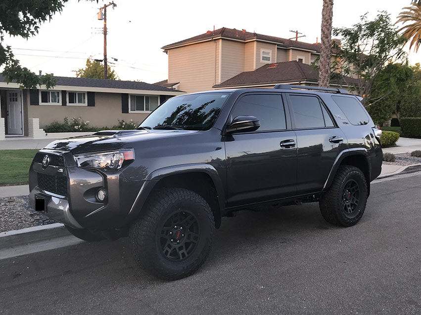

I run 285 K02 on factory Trail Wheels. I did a 3" OME suspension and SPC upper control arms. No rubbing, no trimming, no cutting. I have a set of spydertrax that I have not installed because when I do, I WILL hhave to cut, trim, and adjust at the fenders and flaps.

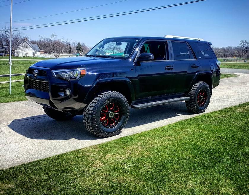

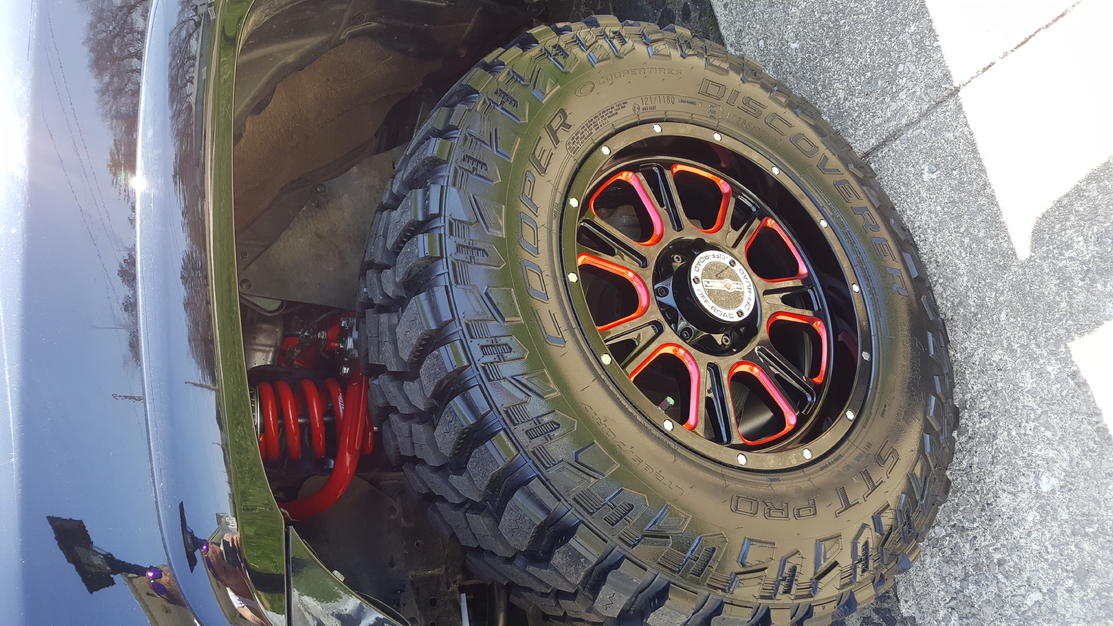

3" Toytec BOSS lift, JBA UCAs, 17 x 8.5 (0 offset) Vision Fury wheels, 285/70/17 Cooper STT Pro
