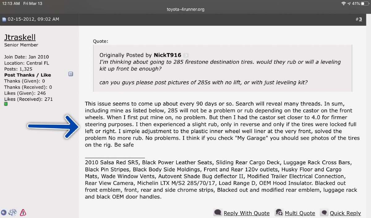

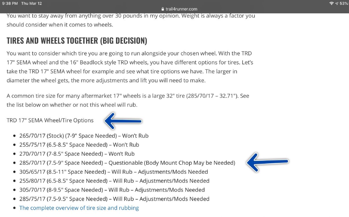

TRD wheels, 2” front spacer lift, 285/70/17. What is the reality of this plan?
On one hand you get this.....
And then to the next guy it’s nothing. A minor wheel well liner adjustment, which was barley necessary according to him....
These 2 assessments are very typical of this same question and a coin toss isn’t the best basis to start modifying a 2020 Pro with 500 miles on it. I’m kinda surprised this isn’t a question with a unanimous answer to it given the volume of T4R owners here who’ve modded them for years.
