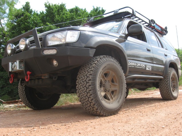

I Also have 285s on my stock 16" rims

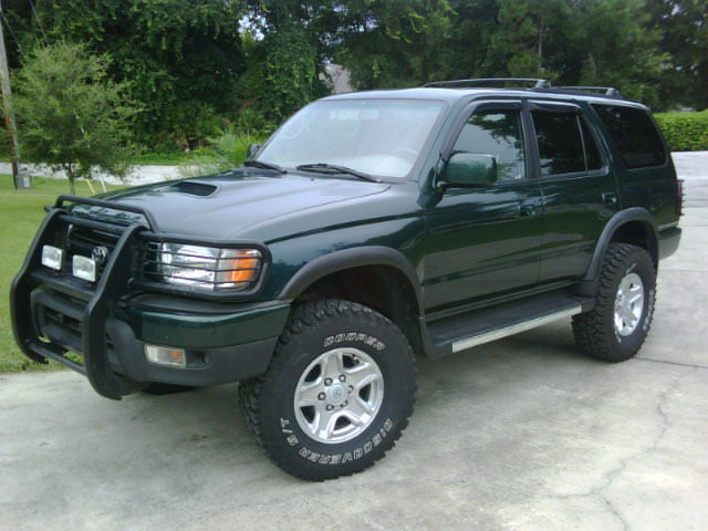

I'm using 1.25 Spidertrax spacers on stock 16X7 5 star rims. 3" OME spring lift on my '99.
I do get a little rub at full lock, but I have not pounded down my pinch weld yet. 285/75r16 Cooper ST. I'll have some Goodyear Wrangler MTR's mounted up by the end of the weekend though.

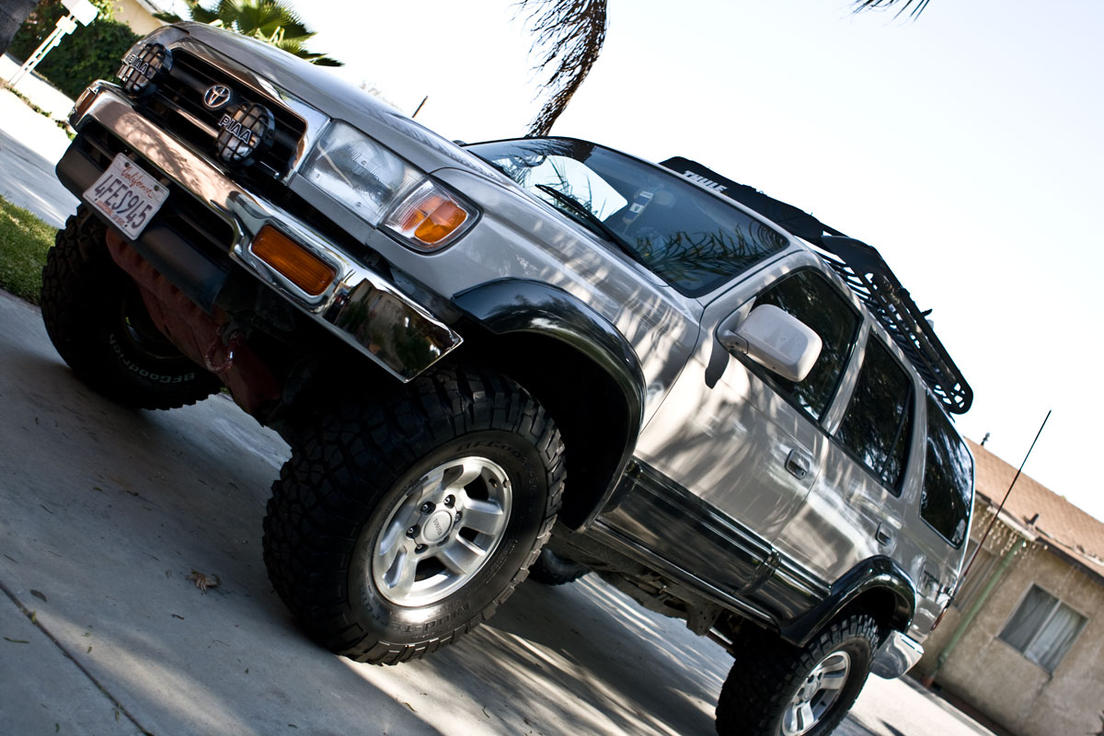

here's mine on stock 5stars o ya i had the wheel weights put on the inside i just cant stand them on the outside
DSCN2100.jpg~original

denvertoyota said:
Agreed, except your stock front bumper sits to low...is that from a body lift? yes it is
yes it is, that was before the bumper bracket. this is how it looks now.:biggrin2:
PS you don't need the spacers, but you do rub a little little bit on the runners Metal frame i never notice it till recently
