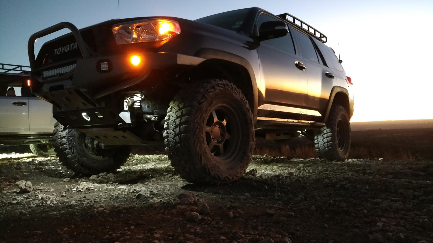

You can get them to fit. Most people run them with 17x8 - 10 offset (4.1BS).
It still requires some trimming.. and a body mount chop. Probably also need to relocate the washer bottle like I did. Caster also needs to be maxed out...
I'm running 305 70 MTRs, which is about the same at 34.1" diameter.
I flex my truck out all the way often.. And I only get a very faint rub here and there. Nothing I can even hear really, but I can see slight evidence under careful inspection.

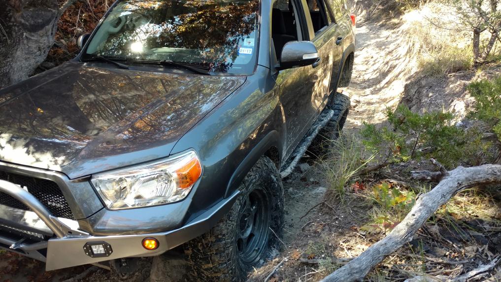

They fit! That's my exact setup. I put the wheel/tire on without the coilover so I could run the suspension through full articulation. My setup fits with zero rubbing. I am not running spacers. I tried to, but they rubbed when I tested the full articulation. I'm not sure about the BMC, since I performed it prior to my lift install.

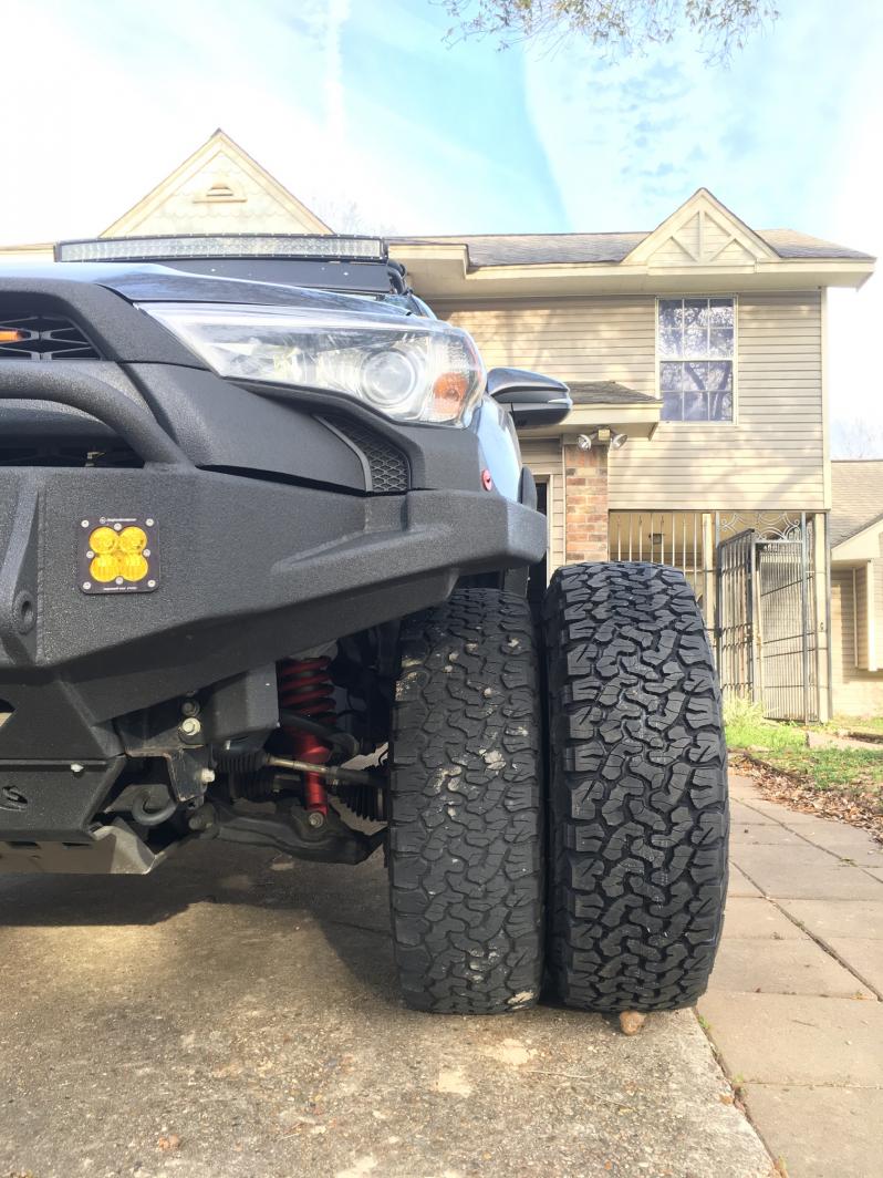

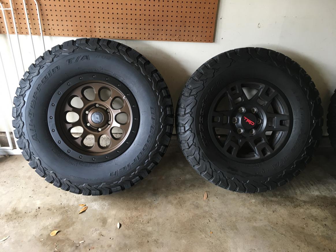

285/70 BFG KO2 on 17x7 (~50% tread) vs 285/75 BFG KO2 on 17x8.5
BFG and their whack sizing. spec'd to be taller, but looks wider / larger tread blocks. haven't tried to measure anything yet, I'll update over the weekend
edit:
measured both wheel/tire combos off the vehicle
285/70: 31.5" (with about 0.5" tread worn)
285/75: 33"
i thought the 75's were wider but both measured 9" across the tread. i think its an optical illusion due to a 1.5" wider wheel (better suited for 285) and the tread blocks themselves being physically bigger to accommodate the larger circumference

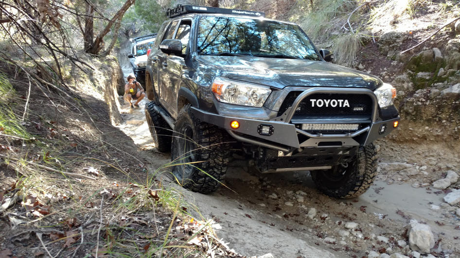

It's close - but does not rub anywhere at full stuff at any steering angle. The only minor rub I get is on the front bumper cover in reverse at full steering lock. I looked for a pic at full stuff. You can see it's close - but it doesn't ever touch. I have just the regular OEM bump stops.

Recently put 285/75's Wildpeak's on my truck and regret not doing it sooner.
I'm running a 3/2 lift with -10 offset wheels and SPC uppers running 4 degrees of caster - running a 2inch extended bump stop in the rear and Wheeler's bump stops up front.
Couple of things worth noting:
- Had to re-do my BMC to get a lil' more aggressive with it, but not a big deal.
- Trimmed the front lip of the bumper to prevent rubbing in reverse
- Bent in the pinch weld
- Removed my valence caps (will trim them eventually), no rub when driving on the street but it gets real weird when flexing out.
But that was it. No rub from what I could tell (or saw/heard). I loved having the extra tire and it was super grippy at 15PSI.
