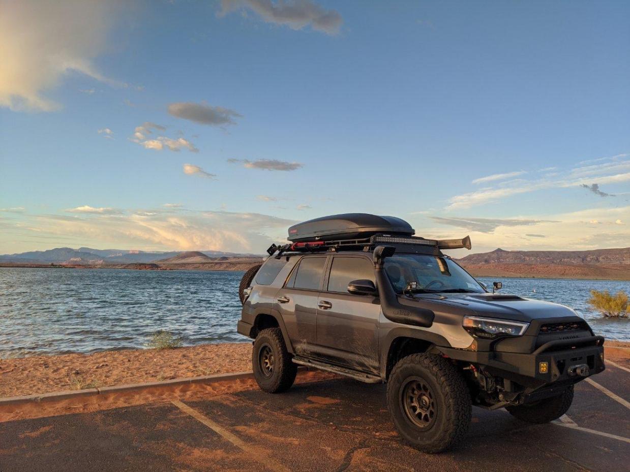

Platform: 2019 5th Gen Off Road 4-Runner, Icon Stage 7 Suspension, SPC Performance UCAs, CBI front and back bumpers, body mount chop, pinch-weld folded over, 4.88 Nitro re gear, Harrop E locker up front.

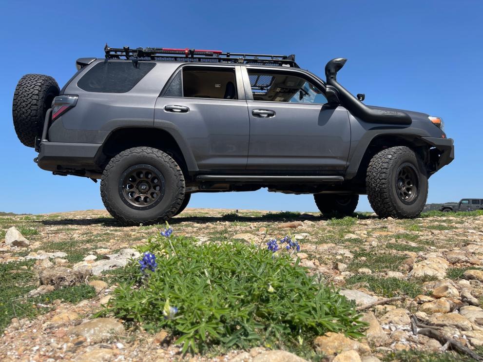

I've run 285/75's for about 4 years and I run those exact tires now. I like the tire size in general and have been on the ST Maxx's now for about 6000 miles. They are an excellent preforming tire that I can definitely recommend although they aren't light and are more aggressive than the average AT. It's tall for a 285/75 @ 34.1" mounted on the rig. They do follow the road grooving some but not terribly so. Noise isn't bad at all. I think with your wheels you might have some rubbing even with the pinch welds hammered. I have BMC and pinch welds hammered also and lots of trimming in the back fender well. Caster approaching 5*. My wheels have much less offset than yours, +1 mm 5" backspacing. I ran 305/70's at one point without a problem

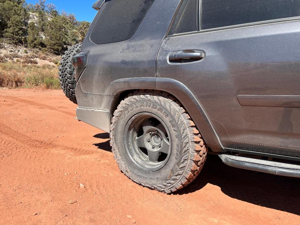

I’m going to switching out my P rated Falken Wild Peaks ATs in 285/70/17 for some Yokohama Geolandar G003 MTs in 285/75/17 soon. I’ll admit I got the Falkens not expecting to go off roading much. But once I did, the bug got me good. I’ll share once I get them mounted

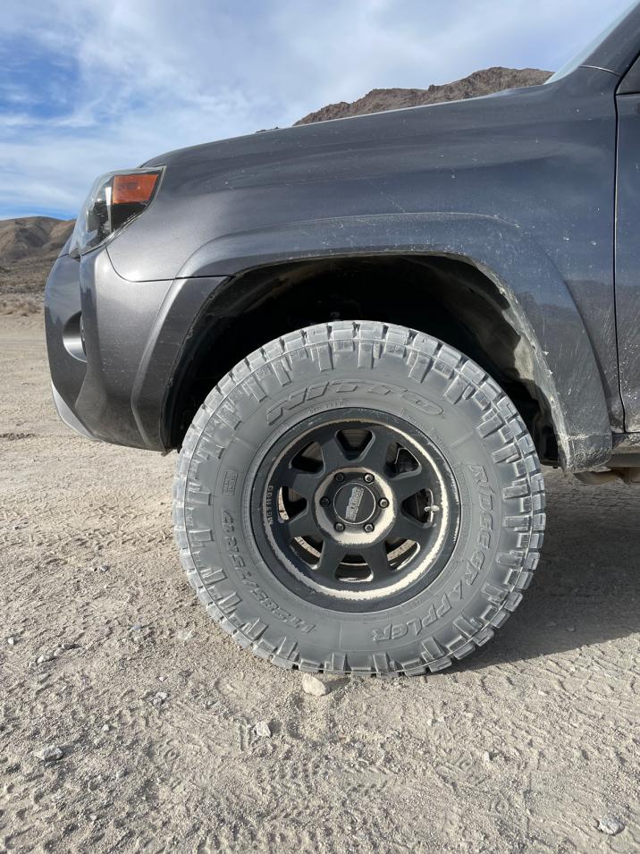

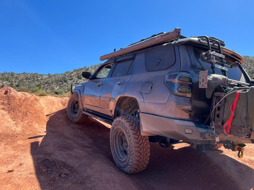

I debated back and forth between 285/75 and 285/70, after seeing [MENTION=127657]codyHTX[/MENTION] 's comparison post I wanted to go 285/75 KO2 but they were out of stock for a few months so I went with Ridge Grappler's in C which are a bigger tire than the KO2's but I measured it out with my method 701- 17x8.5 - 0 offset and just took the risk. So glad I did.

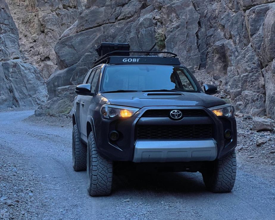

I've got about 2k miles on them so far, lots of freeway/around town and then last week a trip to Death Valley; Titus canyon and Racetrack Playa @ 17psi.
So far I'm loving them. Maybe slightly quieter than the 275/70.17 K02's I had previously. For weight I can tell there is a difference but the truck is already slow and I don't have a lot of weight so I personally find it negligible and worth it so far. On a 1000mi freeway tip from Southern CA to Northern CA I tracked my file and got about 1mpg-ish less than before sizing up.
For fitment; I've got a about a 2/2 lift, I had a BMC done and had a bit of plastic trimmed from the front fender as well as the caps below where the mudguards were. I'm still rubbing a tiny bit on rear plastic where it comes down and meets the pinch weld but only when pulling into steeper entry ways around town, I didn't rub at all in DV but those trails have very little in terms of articulation.

Front end at full flex, will hit the upper inner fender and pinch weld (if flexed and wheel turned). Will either require extended bump stops or alot of hammering to inner upper fender, and pinch weld mods and BMC. I choose extended bump stops. Seriously, its pretty easy fixes.
Rear tires, no problem with extended bumps....
see pics for reference:
