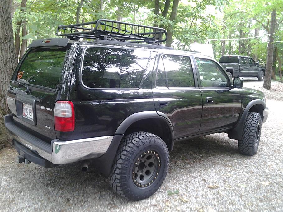

Here's mine with the toytec ultimate lift and 265/75r16 duratracs. I to was undecided between 285's and 265's but the mpg's was my deciding factor.

And a side shot like this or more straight on?
I like that, looks like a great balance between a DD and something too impractical, nice shot!
