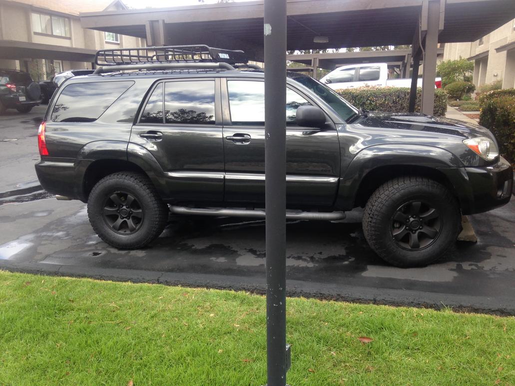

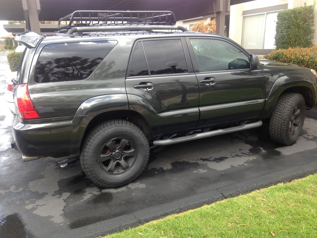

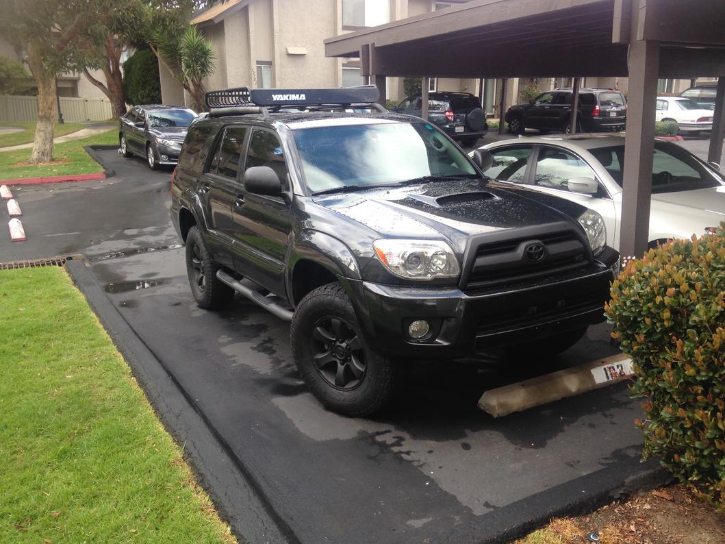

Update 2
Ok, just pulled the trigger on a set of 275/70r17 BFG KO2s, will be installed tomorrow! Hope they fit! Will post pics.
Thanks again to everyone who commented with advice and experience, and a BIG thanks to the lift/tire size sticky!!
Let's see pics of your ride with the new tires. I'm trying to make the same decision with my 2003. Currently have the 2.5/1.5 Daystar.
Will do! I'll snap some photo today and upload them. I really like the setup, the KO2s have a super agressive tread, but they're quiet on the highway.
Bam!
[/URL]~original[/IMG]
Daystar kit with no wheel spacers as of yet. Bit of rubbing at full lock in reverse with flex, but none other than that. Love it!!
Looks awesome bro. Nice choice. You've made my decision easy. I'll be joining you with the exact same tires soon!!! Thanks for posting.
No prob dude! I am really impressed with those tires. Stopping distance is a little longer and acceleration is slightly decreased and I lost a bit of mpg but it's more than worth it.
