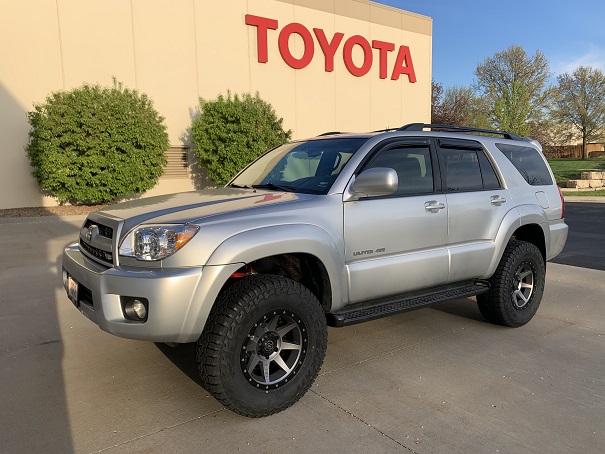

Just finished lifting my 07. Bilstein 5100's and FJ springs at all 4 corners and added JBA upper control arms. Front shocks at highest setting (2.5") with 1.5" Daystar spacers in the rear. Icon Rebound wheels with 285/70/17 Falken Wildpeak tires. Had to trim the front bumpers very slightly and had to move the liners forward some. No rubbing while turning and going forward, but when in reverse and turning either right or left at full lock, the tires just barely touch the cab mounts. They touch so very little, i'm not even going to worry about it. Unfortunately it does have the driver side lean though. Passenger side is 1.25" higher than the driver side. I've already placed a Toytec 1/4" spacer at the left front, but it made no change to the rear. Still debating what to try next...

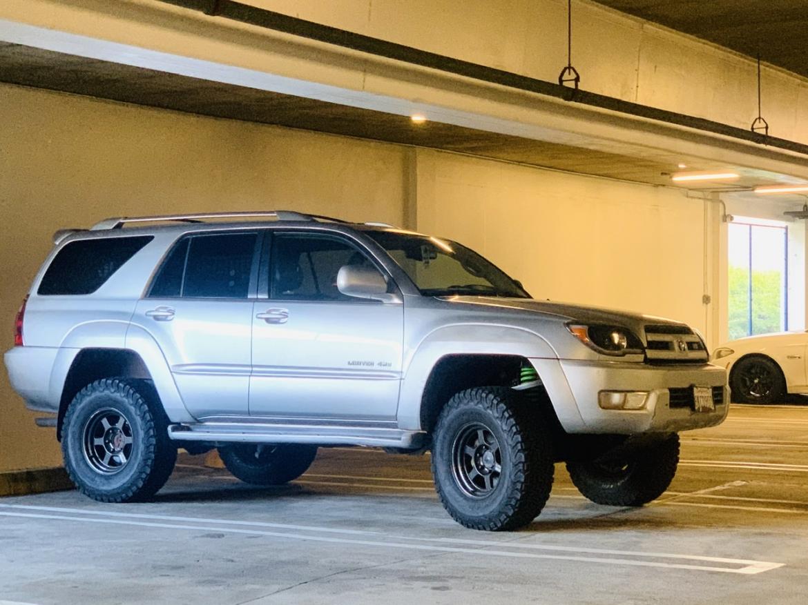

285 75 r16 with Ironman4x4 lift
I have a spacer in the driver rear 25mm to Assist in the 4runner lean

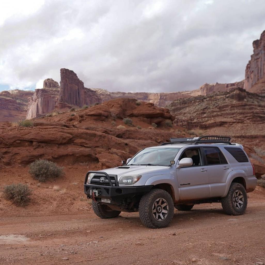

I'm at about that height in lift. Fits fine, if I really slam it I still hit the fender liner, but I don't really care.
